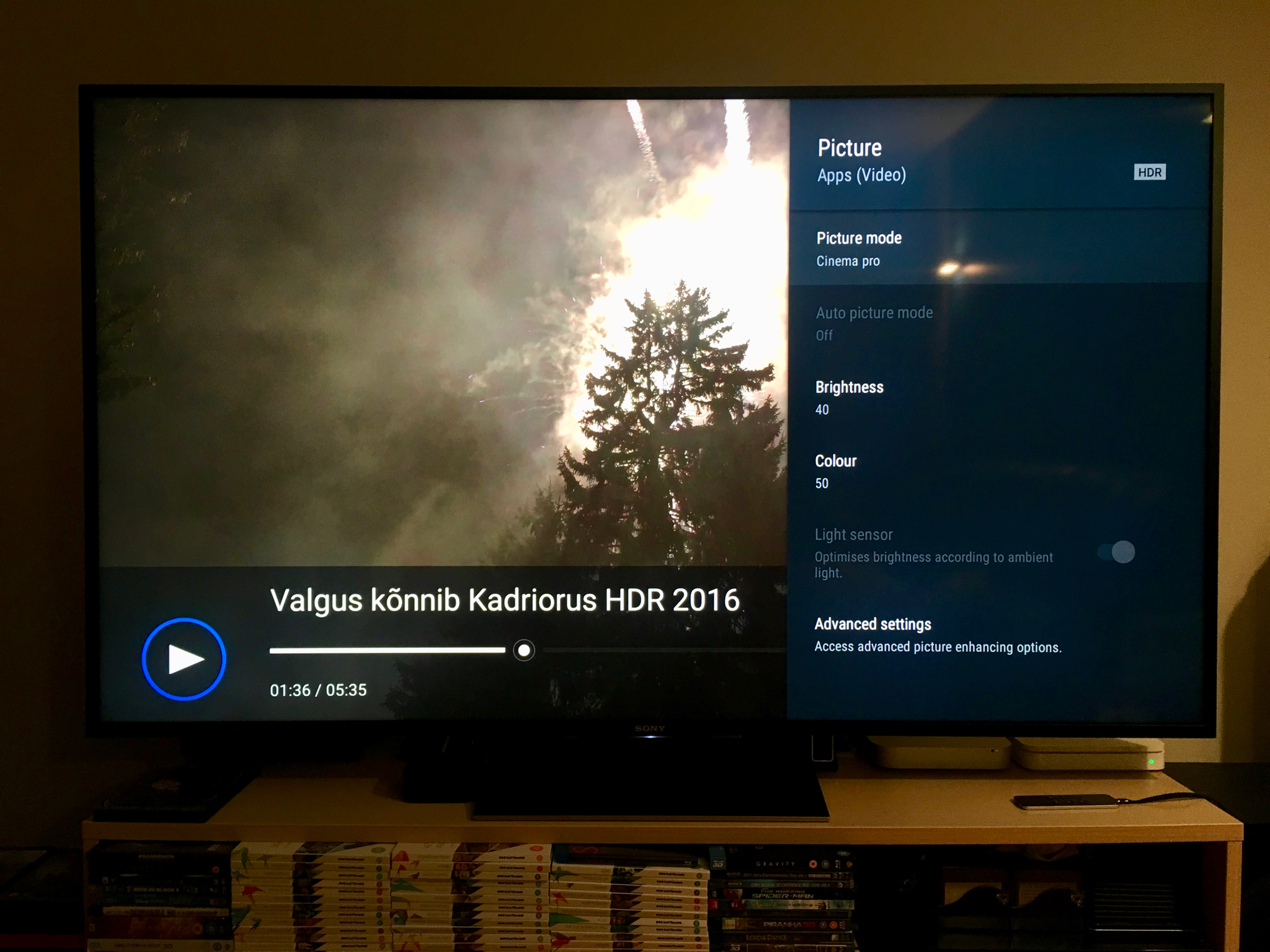

On a Sony, you can see if screen is in HDR mode by selecting Options - Picture. Screen will be different on android V6 and V7 but the HDR lettering must be seen.

What sony tv do you have? On mine it appears like this:
