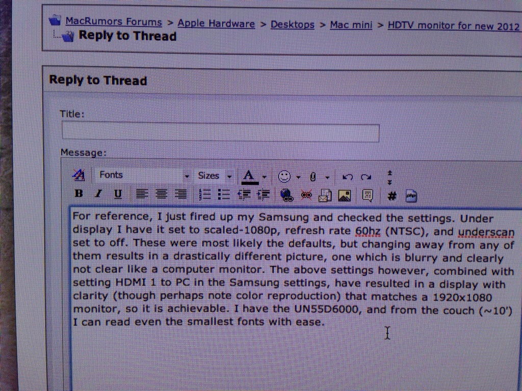

For reference, I just fired up my Samsung and checked the settings. Under display on the mini I have it set to scaled-1080p, refresh rate 60hz (NTSC), and underscan set to off. These were most likely the defaults, but changing away from any of them results in a drastically different picture, one which is blurry and clearly unlike a computer monitor. The above settings however, combined with setting HDMI 1 to PC in the Samsung settings, have resulted in a display with clarity and sharpness (though perhaps note color reproduction) that matches a 1920x1080 monitor, so it is achievable. I have the UN55D6000, and from the couch (~10') I can read even the smallest fonts with ease (as long as I have my glasses on!). I would definitely keep the PC setting on the Samsung and play with it from there. If you have any specific questions let me know, I'll keep it hooked up for a while.

I haven't changed any font sizes or settings on the mini, nor any settings on the Samsung besides the input name. Color temperature is a bit off but it's fine for my purposes. Attached is a photo of the screen displaying my earlier post, if it helps.
The text is very legible. I will say that from less than a few feet the pixels are so large that it becomes less clear, but this is the same as any monitor, and from a distance that makes the pixels no longer discernible the fonts are very clear at any normal size.
As soon as I switched the name of the input to PC on the Samsung it was like I went from watching a youtube video of a computer screen to an actual monitor, I am disappointed it wasn't as simple for you. Have you tried attaching another computer to see how it fairs?

Do you notice any change when switching the name to PC? Because with it off my display is scaled wrong, everything is jaggy, and fonts are definitely much less clear. Also, I have the 2011 mini with the 3000 graphics, not sure if that could have something to do with it.
Oh yeah, of course. There was a huge change from any other source type to PC. It actually looks pretty good, I just think that the font is a little off ... but I may have reached the limits of what an HDTV can do.
