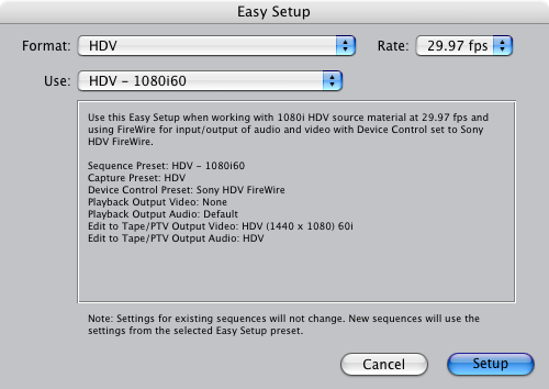

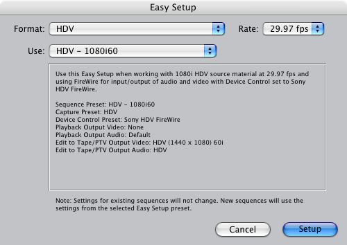

Alucardx03,
To transfer the video from HDR HC7 to FCP, connect camera to Mac using Firewire.
Start FCP.
Select "Easy Setup"
  • Format = HDV
  • Rate = 29.97 (in case you are US based)
  • Use = HDV - 1080i60
Create a new project.
Under file choose "Log and Capture"
Start the tape and press the "Now" button.
Your footage will transfer to Mac without conversion at native format.
One hour tape will be around 11 - 13 Gb.
Regards
Coen
