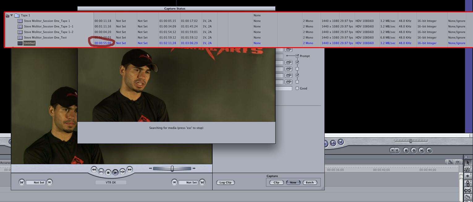

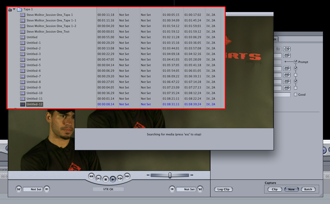

I use Final Cut Pro 6, kept up-to-date, and am digitizing several HDV Mini DV tapes. Using a Sony HVR-5ZU Pro Camcorder and attaching to my MacPro via Firewire 400. I have tried several ways of logging clips, and despite adjusting settings and trying different methods, it creates a new clip every 30 seconds to 90 secs. So my 60 min video ends up being about 40 clips in total with a short momentary break between so that speakers have a word missing in there dialogue, etc.
I have noticed that whenever it creates a new clip it says in the capture dialogue window: Searching for Media
I have also tried Apple Pro Res and Intermediate Codec and neither captures past 20 secs, before telling me it is done capturing.
It creates a new clip everytime you pressed the Record button on the cam to start recording again. HDV sets those markers and FCP utilizes them.
Have you tried cleaning the heads of the camera you are using for capturing? The video shouldn't 'break' in the middle of a shot.

I have this already set. I am now trying with an external tape deck, the sony HVR-M25U, and get the same thing. How is it possible there are this many dropped frames??
Hey Alexnl
I've had the same problem just a few hours ago... so like a good student I went to the FCP manual and I just realized what was the problem.
The HDV capture is configured to "Create new clip on start/stop" in the Clip Settings tab of the Log and Capture Window, so you can deselect the box and the problem is solved.
