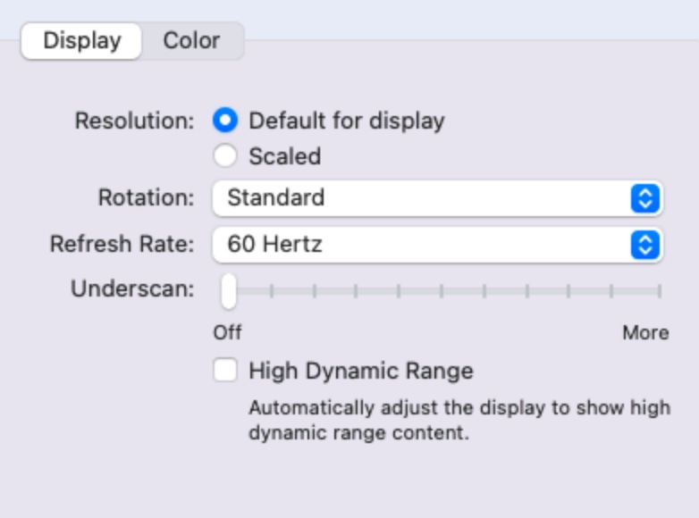

Select "Default for display," then hold the option key down while you click "Scaled". That will give you all of the resolutions, including 1680 x 1050.
Unfortunately tried that, including 3 resolution switching apps, all of them only give 1920*1080 (this was the resolution of the TV i used to set it up initially, seems like it's stuck on that maybe?
You don't need an app to do this. Mine is connected to a 4K TV. Follow carefully:
Step 1 - Select "Default for display"
Step 2 - Hold down the option key and select "Scaled"
