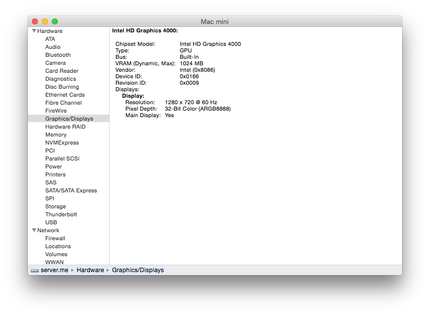

This what I see on 10.10.4 in headless mode, I'm not sure if that means the GPU is enabled. Do others who have 10.10.3 see the same?

With the headless mac mini adapter I saw no improvement to graphics performance. It seems the GPU was enabled before without the adapter. In fact adding the adapter bought back the black bar at the top of the screen. So it seems the GPU is enabled in 10.10.4. I am using the app, 'display menu', however.
