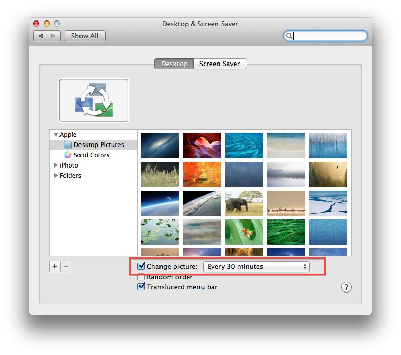

Have you tried setting the background to change every minute?
This worked for me, it keeps the screen refreshing. Haven't had a complete "black-out" since.
The desktop background
