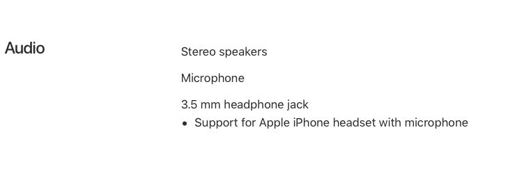

Actually, the port only supports the input of a microphone from a set of Apple headphones.
From: https://www.apple.com/ca/imac/specs/
So, if I were you, I'd ask the folks at Apple if they have a cable that could be used with 3rd party devices that you could utilize the proprietary interface they're using.
