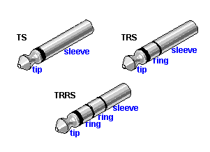

Ed #2: You want a 4-pin, not a 3-pin. There is a ground pin too. So a 3-pin is a normal stereo extension without mic (left/right/ground). Just a clarification for those who are searching on 3-pin.

Everything looks fine, until you receive the cable in realize, that it doesn't work, because only one connector has three pins, the other only two, plus the cable has only two lines.
Nitpicking but those are insulators, not pins. The metal parts of the plug are the rings that actually carry stuff.

Ah, you don't need the mic. Here you go.
FWIW, you need a TRRS plug extension. Tip, Ring, Ring, Sleeve. Most standard headphones with no mic or controls are TRS-Tip, Ring, Sleeve.
http://www.amazon.com/StarTech-com-...dset-Extension/dp/B008DWGLLO/ref=pd_cp_kinh_3
