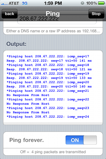

The best way to test connectivity is with a ping tool like Ping Lite.
In this screenshot you can see where the pings stop responding. That happened when I put the lower left corner of the phone in my palm. The pings drop almost immediately after putting my palm there even though the phone still shows a couple bars.
Putting my finger over the two antennas caused the bars to go down but the pings didn't drop or show additional latency
That is probably the BEST evidence, along with the OP video, of the problem.

This is a great way to experiment and determine exactly what does and doesn't affect connectivity of the phone.

It's very important to show that the data interruption occurs when fingers touch antennas.
