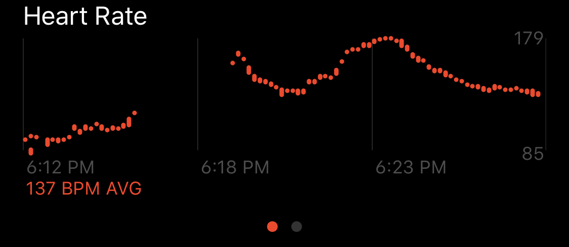

I get intermittent issues with my series 4 Nike version
Never had issue until today....
Super depressing for some reason to not see my normal calorie burn during a workout.
