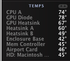

So this temp range would be normal in your eyes? I just bought my MBP and its considerably hotter than my iBook!
Your temps look quite normal. During a simple export/resize in iPhoto of about 7,000 photos, my GPU reached 80, CPU 79. Nothing to worry about.
That's idle? If it is, and you don't live in a sauna or the Sahara, that's hot.
