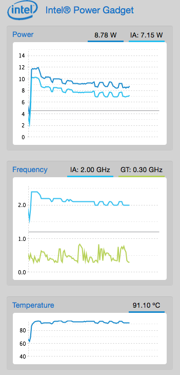

I used Intel's power gadget to track temperature and CPU. I saw some throttling when using the method above; screenshot attached. CPU shot up as high as 2.4, then dropped to a steady 2.0.
I have the 1.2GHz/512 rMB.

As I understand it, the heat throttling is simply to stop turbo boosting and return to the base processor speed (1.1, 1.2, or 1.3 GHz). I don't believe it will throttle lower than that.

This is a better result than I would have expected. Assuming the "yes" commands you ran actually max out all cores/hyper-threads to nearly 100%, then it would seem that it's capable of maintaining a respectable turbo boost to 2.0GHz long-term. I would have expected it to drop back to it's base frequency over time.

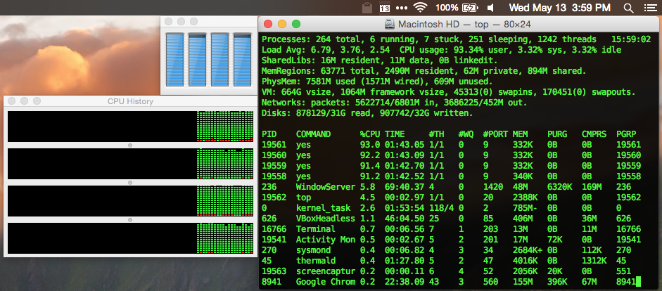

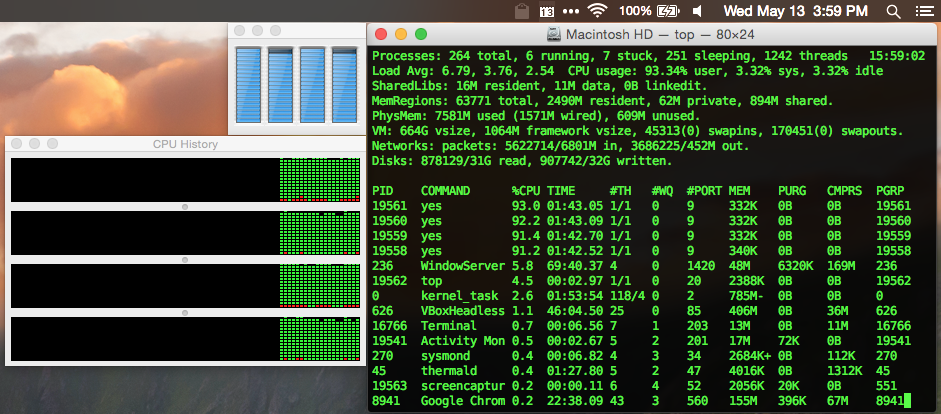

Here is a screenshot of loads on CPU after installing OS X 10.10.4 beta. In 10.10.3 the OS does not spare Core M processors enough time to cool itself down. The CPU usage graph was more like a continuous block. I have played with 10.10.4 beta yesterday evening and my rMB works much more efficiently. It seems like Apple couldn't keep up with OS update plan when they put the Retina MacBook on sale.

@gekkonaut, it is 10.10.3 which has been released that doesn't give the CPU spare time to cool. The unreleased, beta version of 10.10.4 does. I am quite certain because the CPU usage graph under continuous load is "square" which means the CPU is loaded heavily all the time. The shape in 10.10.4 is like the picture above. You can compare the performance to running. By design Core M works like a marathoner, at moderate speed for an extended period of time rather than a 100-meter sprint at extreme speed.

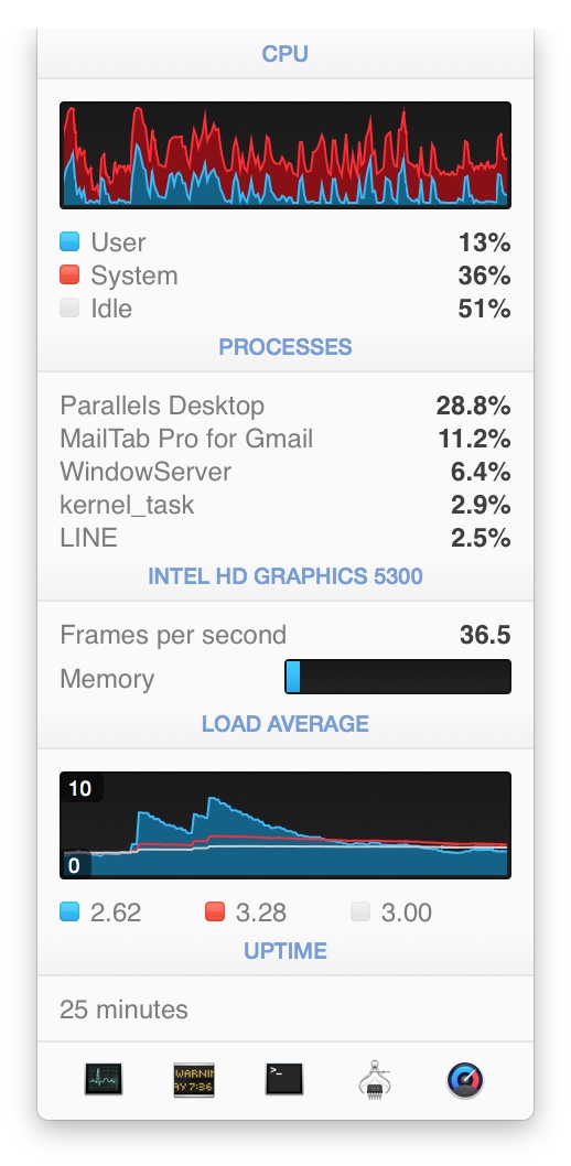

Agreed. I tested mine by running a full system virus scan in my Parallels Desktop Windows VM. That taxes the machine a lot.

Not really. The yes command will try to max out but in reality it doesn't. If you start other applications they'll be started and just run (you can easily run several vm's and 8 yes commands at the same time on a quad core cpu without HT). If it were to max out the cpu that wouldn't be possible since the machine (cpu) is too busy. After a while the machine settles down at a certain steady speed.
That's exactly what you were seeing (it settled down on a steady 2.0). If the machine was throttling due to heat you'd not have seen it settle down on a steady speed but you'd have seen the speed decrease more and more due to heat going up and up. The lowest possible speed of the cpu in the MB is either 1.1, 1.2 or 1.3GHz, not 2.0GHz so there is still a lot of room there.
