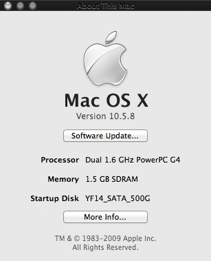

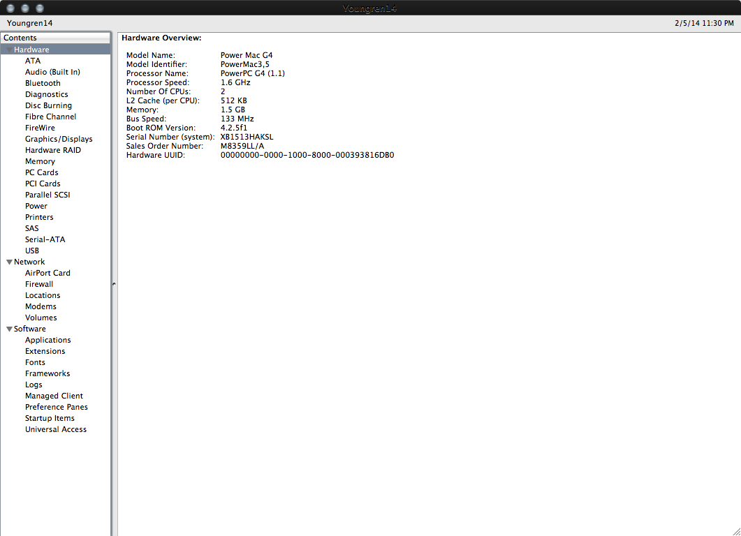

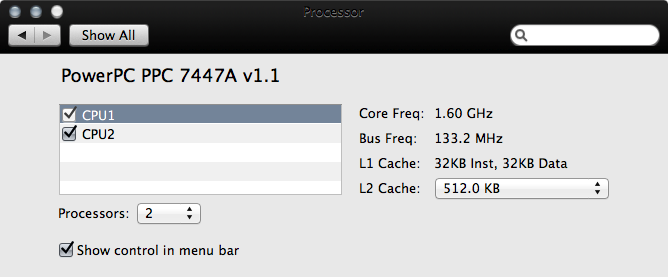

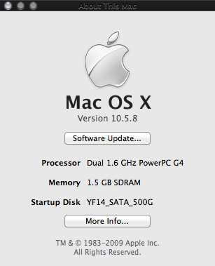

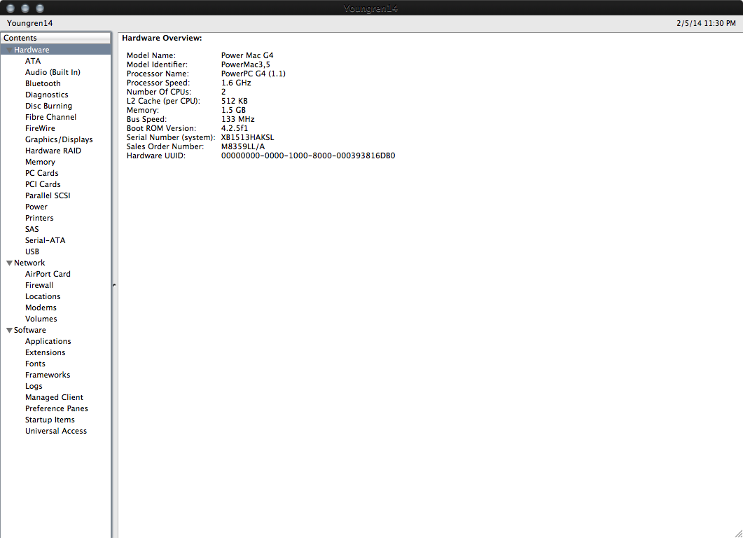

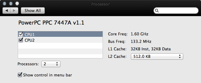

Got all the way logged in and the Mac freezes. So, troublehoot for an hour or so, it only stays up for a small amount of time. Finally, I reread this thread and decide that since the first owner was running this card in his QS at 1.6Ghz, that's what I'll try too.
And now we're stable! I am typing this on a Dual 1.6Ghz PowerMac G4 Quicksilver!
