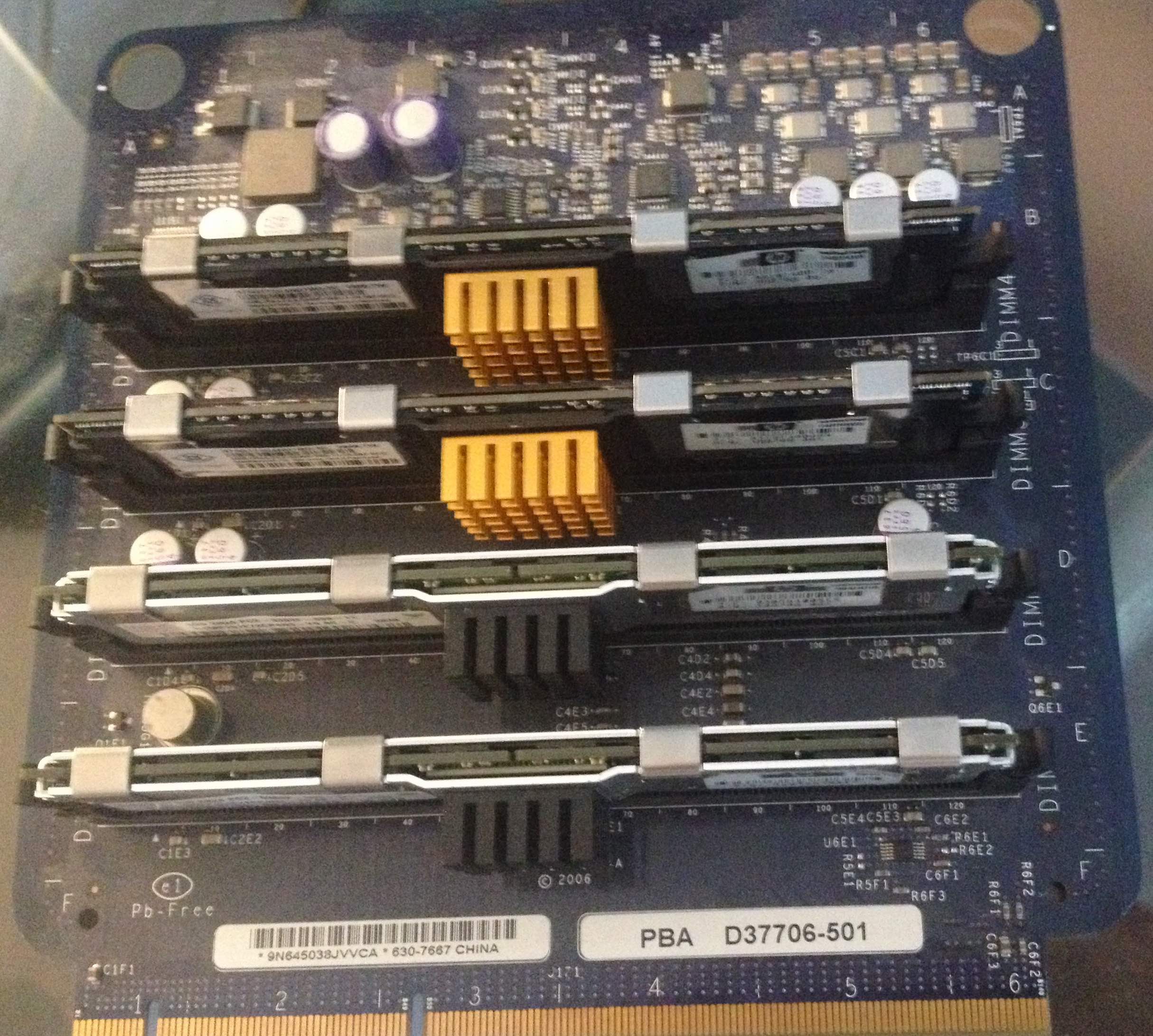

I bought cheap RAM off of eBay with heat spreaders and it really sucked. RAM temperatures were almost always north of 80°C - that's where the fans kick in on my 2,1. I tried to mount different heat spreaders, thermal paste and thermal pads. I had to learn that most of the time it just wouldn't fit. The AMB was never flush with the actual RAM chips, there was always a gap between the HS and the AMB or the HS and the RAM chips.
I decided to go another route and bought some very, very cheap server pull 4 GiB RAM modules from a local IT service company. It came in sets of four, so I bought two sets, one label as Dell and one as HP.
The temperatures where exactly on the edge, hitting 80°C every so often. What I finally did was adding tiny HSes directly on top of the AMBs with thermal conductive adhesive tape. Now I have temperatures in the low seventies.
Long story short: some tinkering may be required with or without the large Apple-style heat spreaders.

Thank you, Sko. Just what I needed. I saw those small heatsinks when I was searching eBay for heatspreaders.
Never occurred to me that cooling the AMBs would be enough.
Again, thanks.
i think it's fairly normal for people to use puled server ram in 1.1/2.1/3.1 and 667mhz speed too as it's cheaper with minimal slowdown.
cool idea sticking on some extra heat sinks @Sko
I did the same exact thing @Sko did in my 3,1. No issues, prevents the fans from ramping up.
