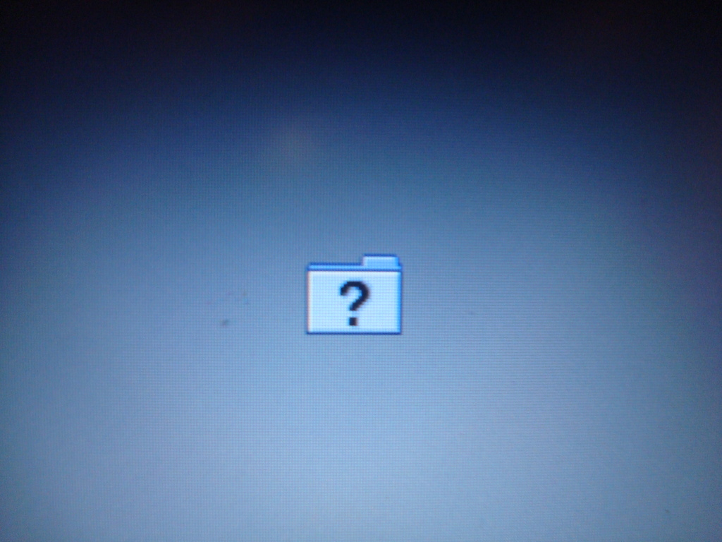

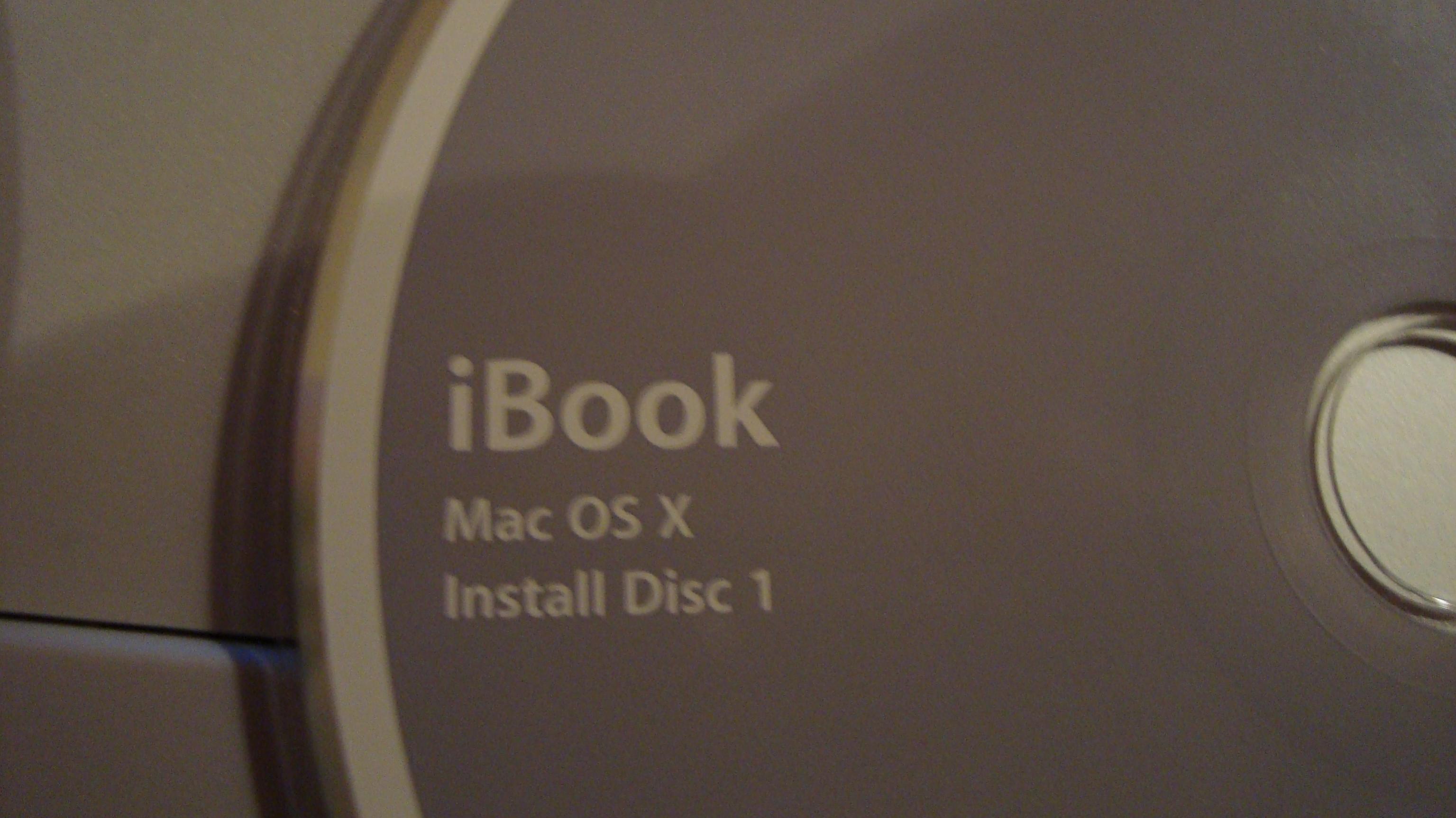

I acquired a Mac Ibook which was working fine in till I decided to reformat it and reinstall the OS. I have all the original Install disks and software disks that came with the laptop. So anyway I installed disk #1 and proceeded to erase and do a clean install. So everything went well but it did not ask for the second disk??? weird. But it said install completed and it rebooted then a folder with a flashing question mark was on my desk top.
What did I do wrong? every time disk 1 is in the drive it keeps on saying it wants to install again nothing else works, why did I do what I did when I know nothing about Mac 🙁 Well all's I would like to do is put it back the way it was. Install the OS and be done. I feel this is going to be a learning experience learning how this type of OS works.

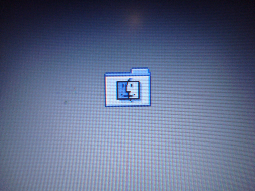

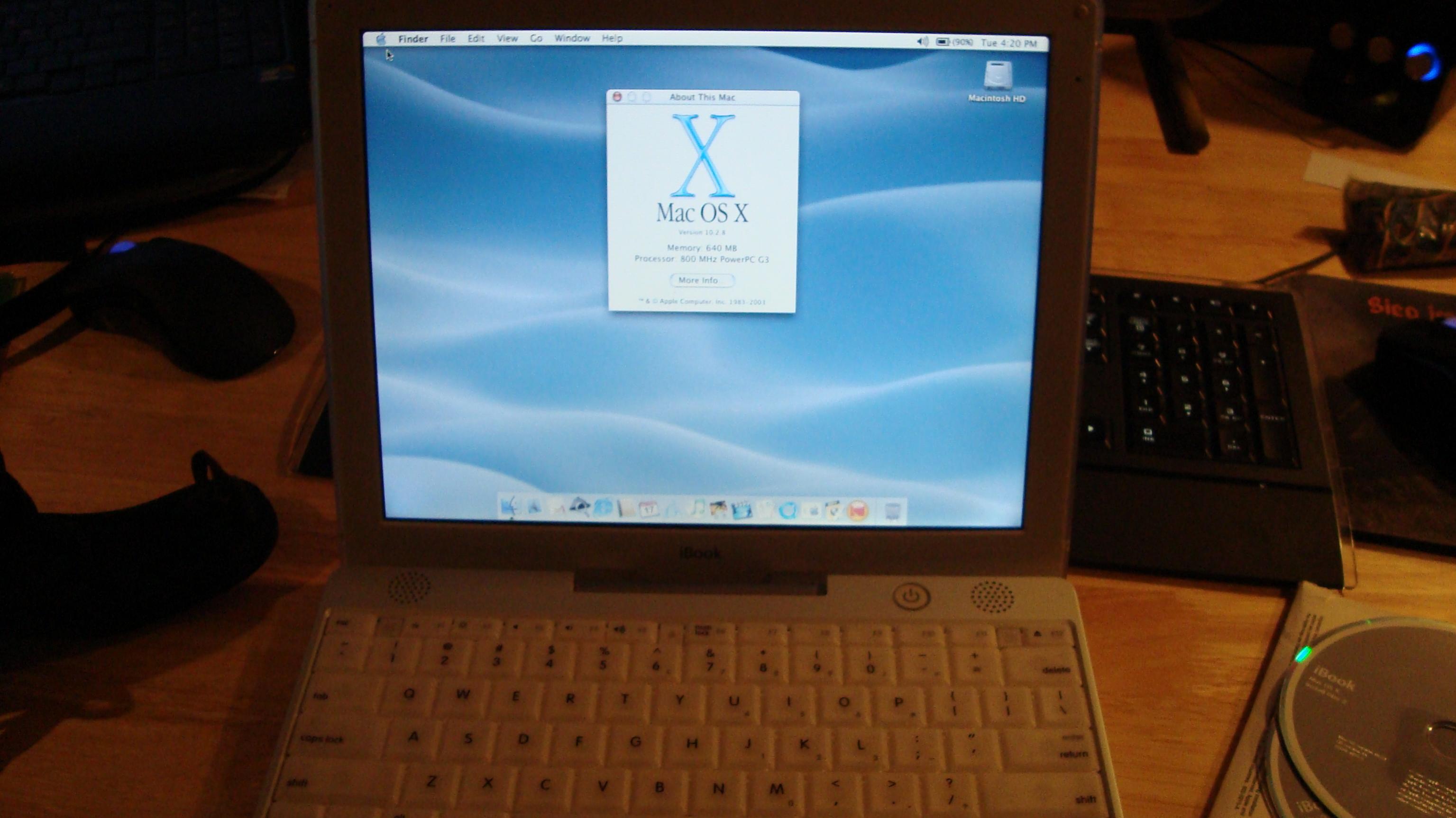

Picture 2
This is the info before the reformat.

Then I get this in my desktop after reboot.
Nothing happens when I put any of the disks in only disk #1 then it wants to install again..

Ok so I did some searches and didn't really come up with any results on how to fix my problem. When I have a flashing folder with a ? and the smiley face its looking for the OS. Well like stated before I did reinstall the OS once but after that it just wants to keep installing it. Then when I try to install it again i get an Error code 0 ..

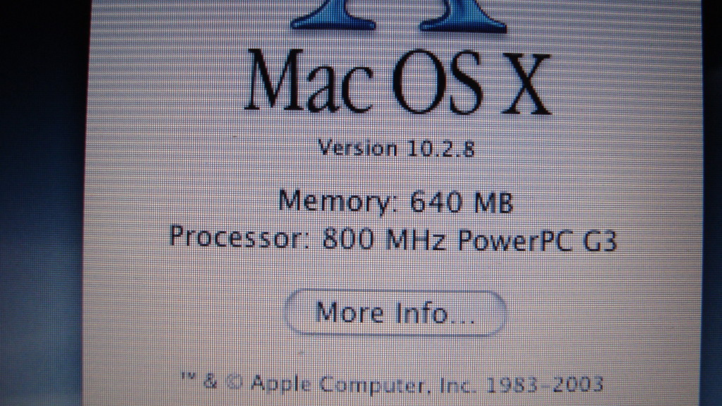

It's a version 10.2.8 well was the install disks are 10.2.1
Memory 640 MB
Processor:800 MHz PowerPC G3 ibook
No matter I do I get this message~~~>The Installer has quit due to an unexpected error. (exit code 0)-Please restart your computer.
When the install starts I dunno 🙁
Boot from the install CD and then choose Utilities menu > Startup Disk. Does the hard drive show up in there?
Also, in your original post you mentioned that it didn't ask for CD 2. That's normal; it'll ask for it after successfully booting from the hard drive.
I was re-reading this to see if there was anything I was missing. Explain this part above very carefully. If you re-formatted hard drive, then installed disc 1, then erased, this would be why you're getting an error cause nothing is there, and hence why it wouldn't ask for disc 2 cause there is nothing on the hard drive asking for anything. That is why I said format the hard drive, and start over.

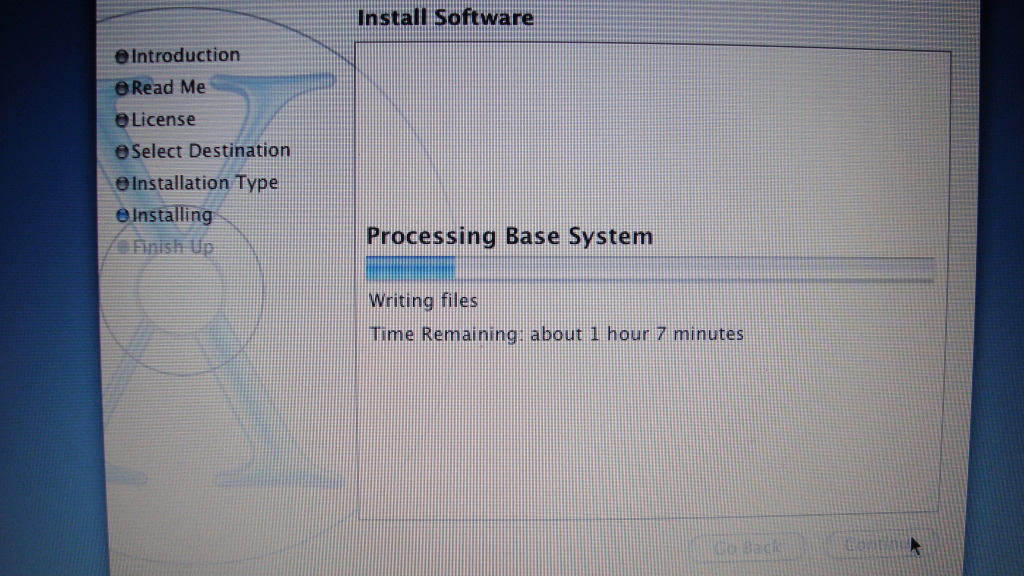

Tried ti install the OS again
OK I tried 2 ways to install the OS onto the laptop.
The first way I tried gave me an error message stating to restart computer right as the install was starting.
The 2nd way I tried things a little different but when it got to the install point there is just a rainbow disk turning and it says Preparing Disk its been sitting like that for about 20 minutes now.
I took pictures of everything as I did this both ways maybe the pics can help out in some way.for the way the pictures uploaded into Photo-Bucket start at the last picture and work your way back Thanx again for any help.
