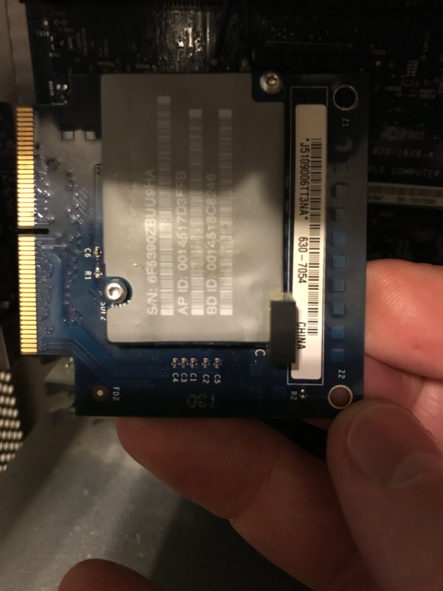

Hello! Thanks for the quick response. Here is a pic of the card and the module attached to it.
I can take other pix if this one does not show what's needed to identify it.

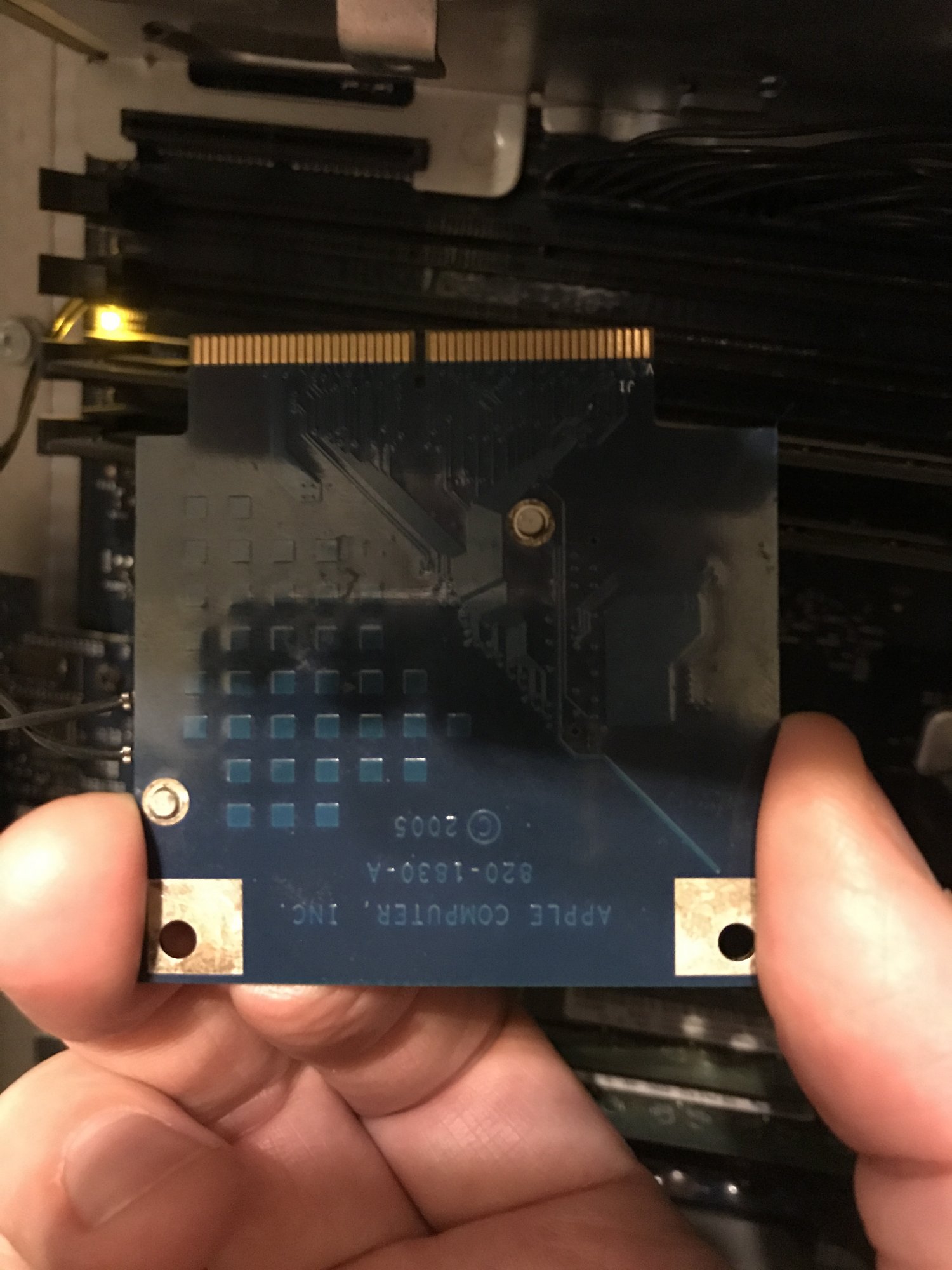

and the flip side:
Hello! Thanks for the quick response. Here is a pic of the card and the module attached to it.View attachment 935330

and the flip side:View attachment 935331

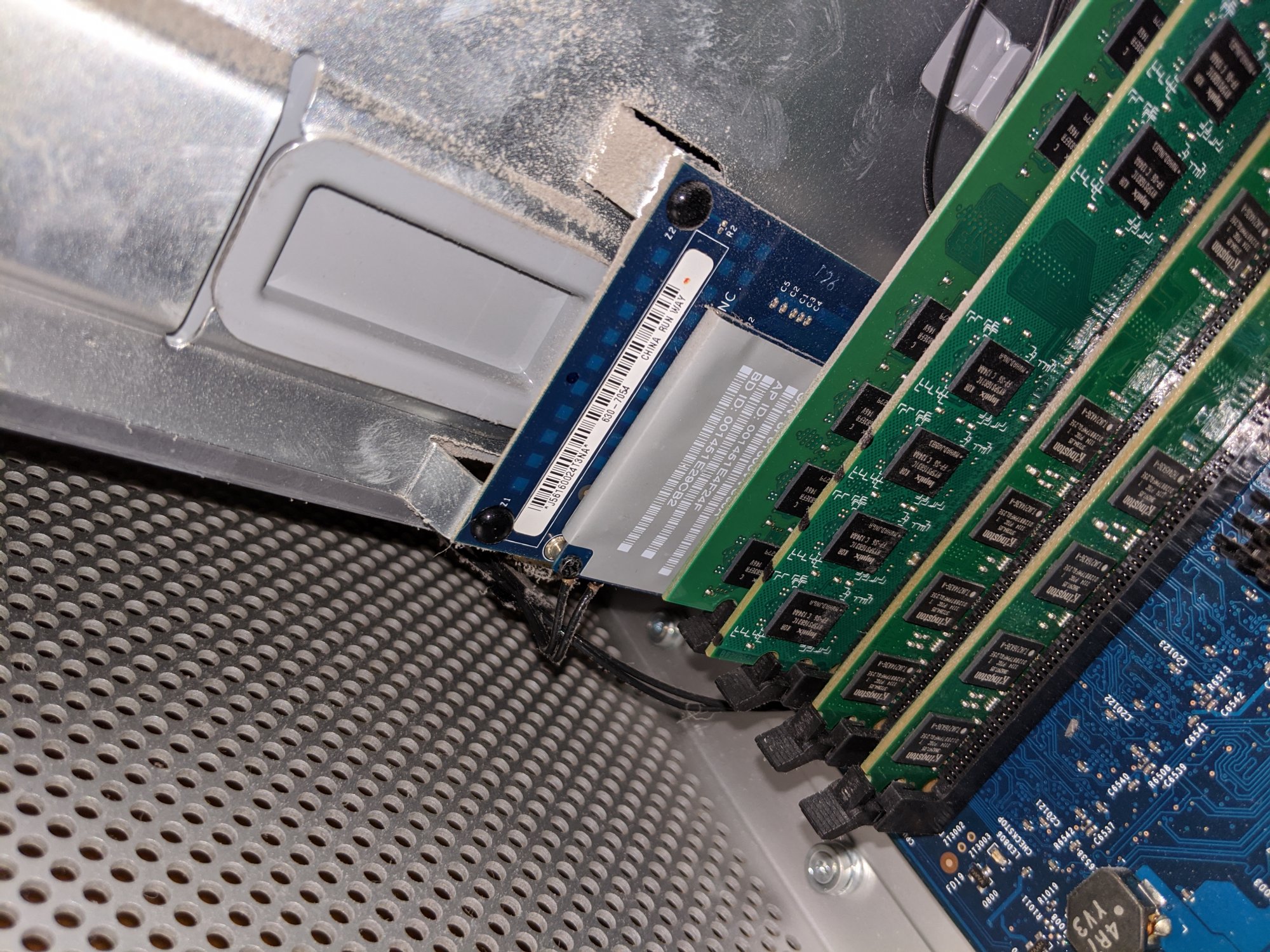

That looks like the right card. Here's mine:
So, I would say that the Airport part is defective or not working. Maybe someone else has something to add.

Yeah, mine appears to be the same as yours. Thanks for checking/confirming and the feedback.
Of interest maybe: I found that I had 2 of the modules - the piggyback piece that plugs and screws into the daughterboard (do we call this the "Runway board/card" or what?) - I did the whole procedure over again, with the other module and I get neither BT nor Wifi. So, clearly that module is DEAD-dead. The 2nd, I put back in and did NVPRAM and System reset - still no Wifi - but BT is working.

The blue board is actually the Runway card. The module that fits on it is the actual Airport/BT module. But without the Runway Card, the module doesn't work. So, if you can find just another module then you can test.
It may also be that the Runway card is itself bad.
You might try cleaning the contacts and see if that helps or not. I don't have a lot of ideas at this point.
