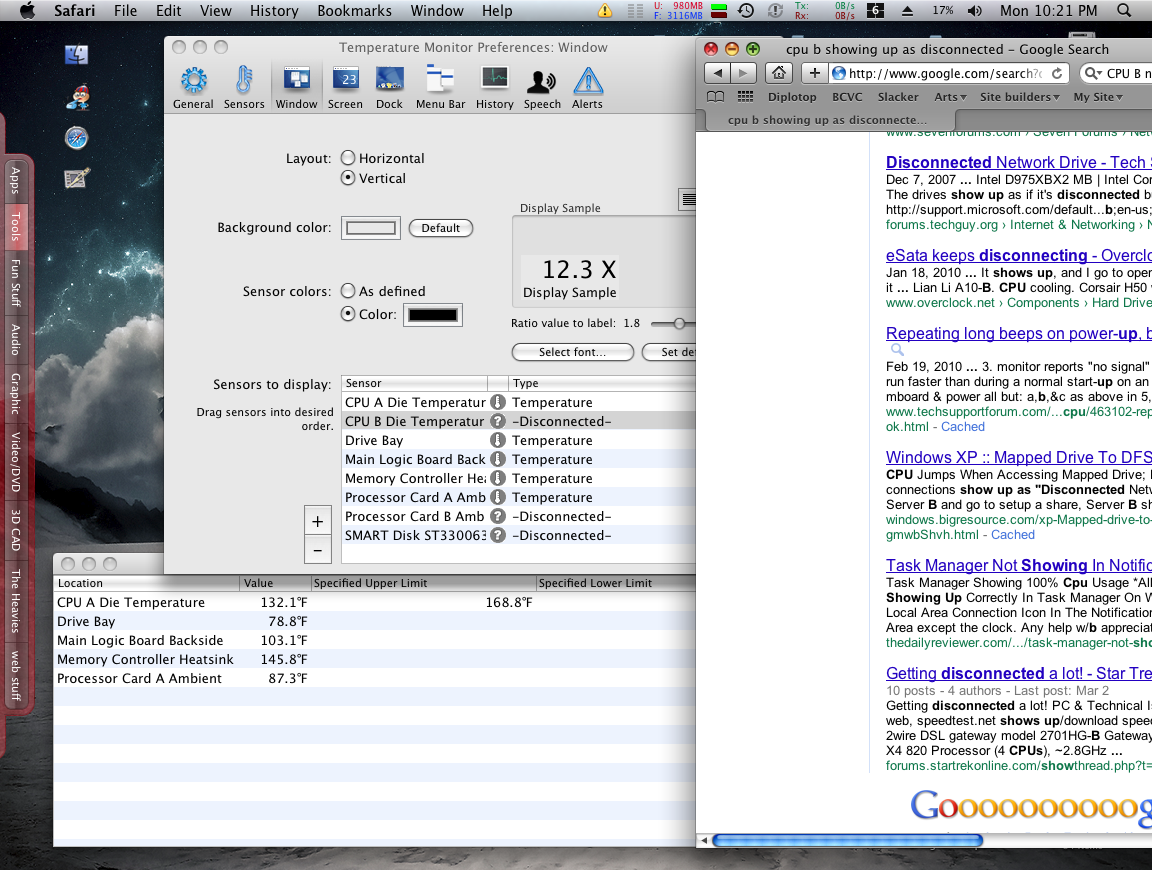

This is an unfortunate development! It appears that one of my processors has died on me! Is this, in fact possible - and still be running?
I have included a screen shot, using Temperature Monitor to show the processors and ambient temps.
What other way could I determine if it truly dead?
And lastly, can a replacement be had? (I'm fairly adept at computer repair) If so, where?
thanks so much for any help!! I really can't afford another mac right now - Help me keep this one alive a bit longer!!

It's something with sensors. S.M.A.R.T. sensor (HDD) says "disconnected" too.
Open System Profiler and under "Hardware" you'll find info about CPUs.
Thanks for the replies. It does appear that it is not in use/dead. Looks like I'm running on only one processor - whoa, I didnt know this was a possibility!!!
What can I (personally) do about it? I want to know if I can fix it cheaply, myself.
If there's no possible way to fix it, can I set up the computer to limp along and not freeze/crash?
Yeah I thought this was odd as well... I thought it was maybe a disconnected sensor cable - but I think that these sensors and internal....so why would the HHD indicate this....
It does show only one processor in system profile (so I guess it's not a problem with the application Temp Monitor somehow reading wrongly) I thought that this was a Dual Processor G5 - not the dual core but an actual 2 processor machine. I seem to remember looking up the manufacture date of Oct 2005. But based on some research this morning, this may be an early 2005 G5. (it's the one with 1 ethernet port and on 3 USB - 2 on the back side, 1 on the front)
If it's causing problems, you can always remove the lower CPU from the system. It will just run as a single processor without any problems. You can find a replacement CPU pretty cheaply on ebay. Just make sure it has the same model #, otherwise it may not work.
You will need to run a thermal calibration on the system once you transplant a new CPU into it. Depending on what G5 you have, you will need the apple service diagnostic disc 2.5.8 for early '05 and earlier and 2.6.3 for the late 05's.
http://www.chipmunk.nl/klantenservice/applemodel.html - paste computer's serial number there for info about your G5 model.
