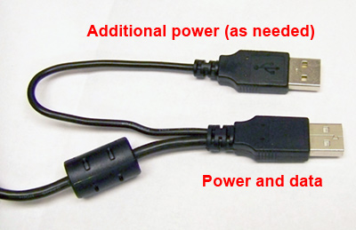

im fairly shore that on my macpro 3.1 the USB ports where not able to power external drives, they may work for a short time then under any load just shut down (eject).
i have a usb hub in my display (that is powered) so i used to use that to use external usb powered drives, an powered usb hub will work too (ie one with a mains plug)
my macpro 5.1 seems to be able to power the usb drives so im gessing it's something that was updated.

i used something like this on my 3.1, it has 2 heads on one end to get extra power
Reactions: ActionableMango
