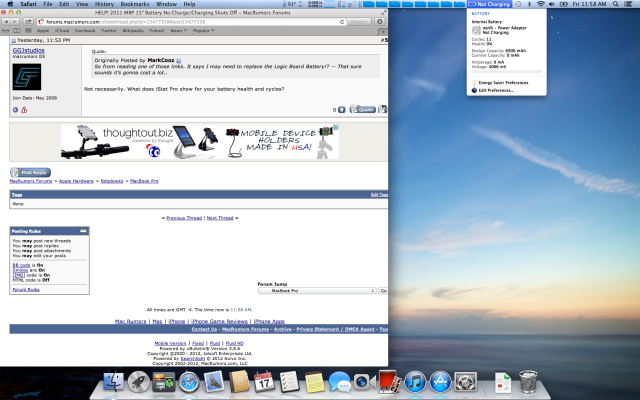

Use iStat Pro (free) or iStat Menus ($16) to get accurate readings of your battery, temps, fan speeds and much more. What is your battery health?

So from reading one of those links. It says I may need to replace the Logic Board Battery!? -- That sure sounds it's gonna cost a lot..

So here's what it says with iStats...

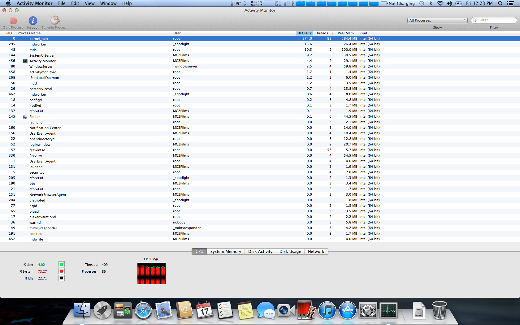

Go through the performance tips I posted. If that doesn't help,
  1. Launch Activity Monitor
  2. Change "My Processes" at the top to "All Processes"
  3. Click on the CPU column heading once or twice, so the arrow points downward (highest values on top).
  4. Click on the System Memory tab at the bottom.
  5. Take a screen shot of the entire Activity Monitor window, then scroll down to see the rest of the list, take another screen shot
  6. Post your screenshots.

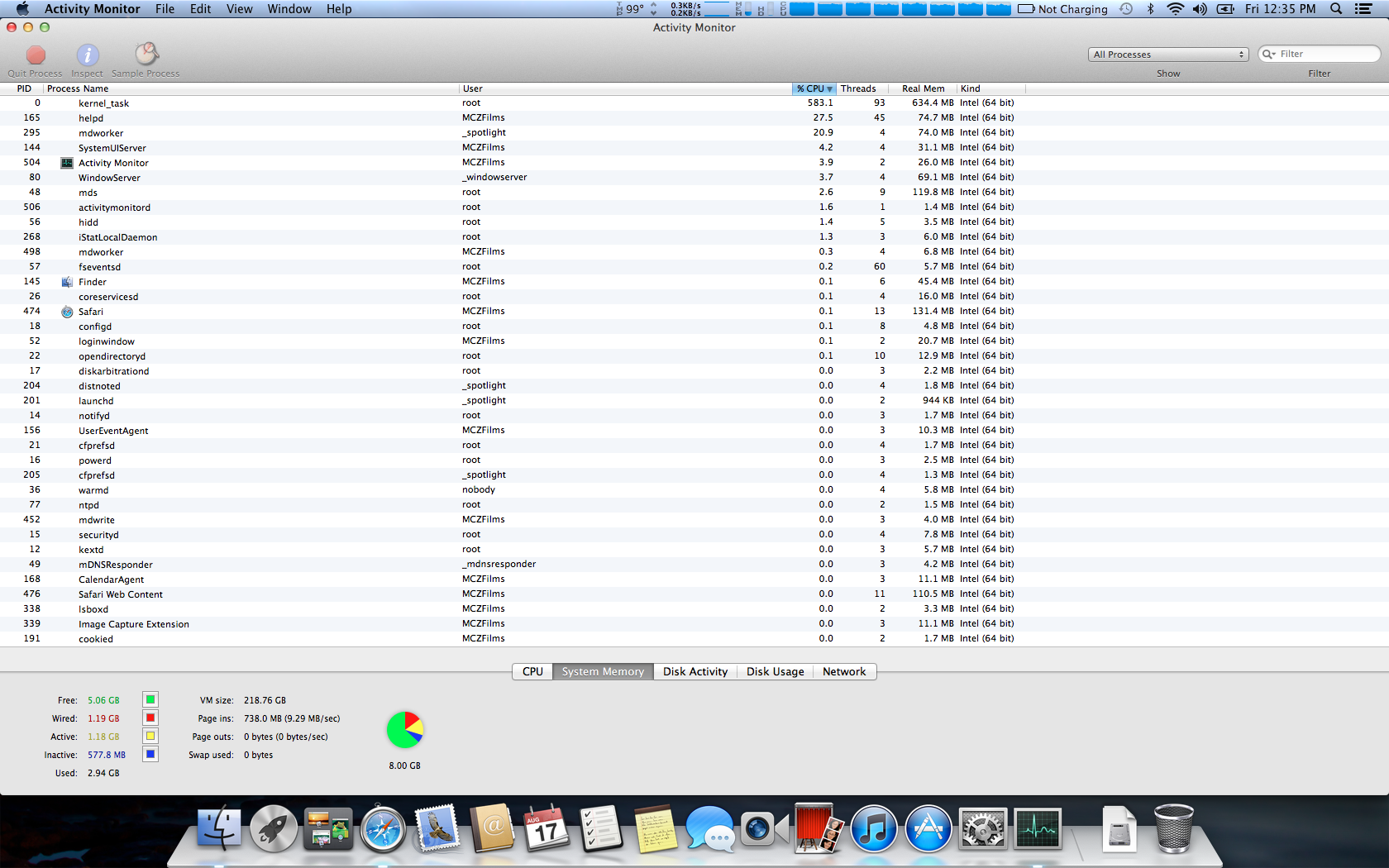

Okay so when I activated spotlight. I noticed that it's indexing stuff for my MacBook.. Would that be causing the lag? That's just one of my thoughts on why my mac could be laggy.. Or battery?

Yes, indexing will absolutely contribute to slow performance. Just let it finish the indexing process, which can take from several minutes to a few hours. After it's complete, check your performance. Also, when posting screen shots of Activity Monitor, don't forget step 4 of the instructions.
