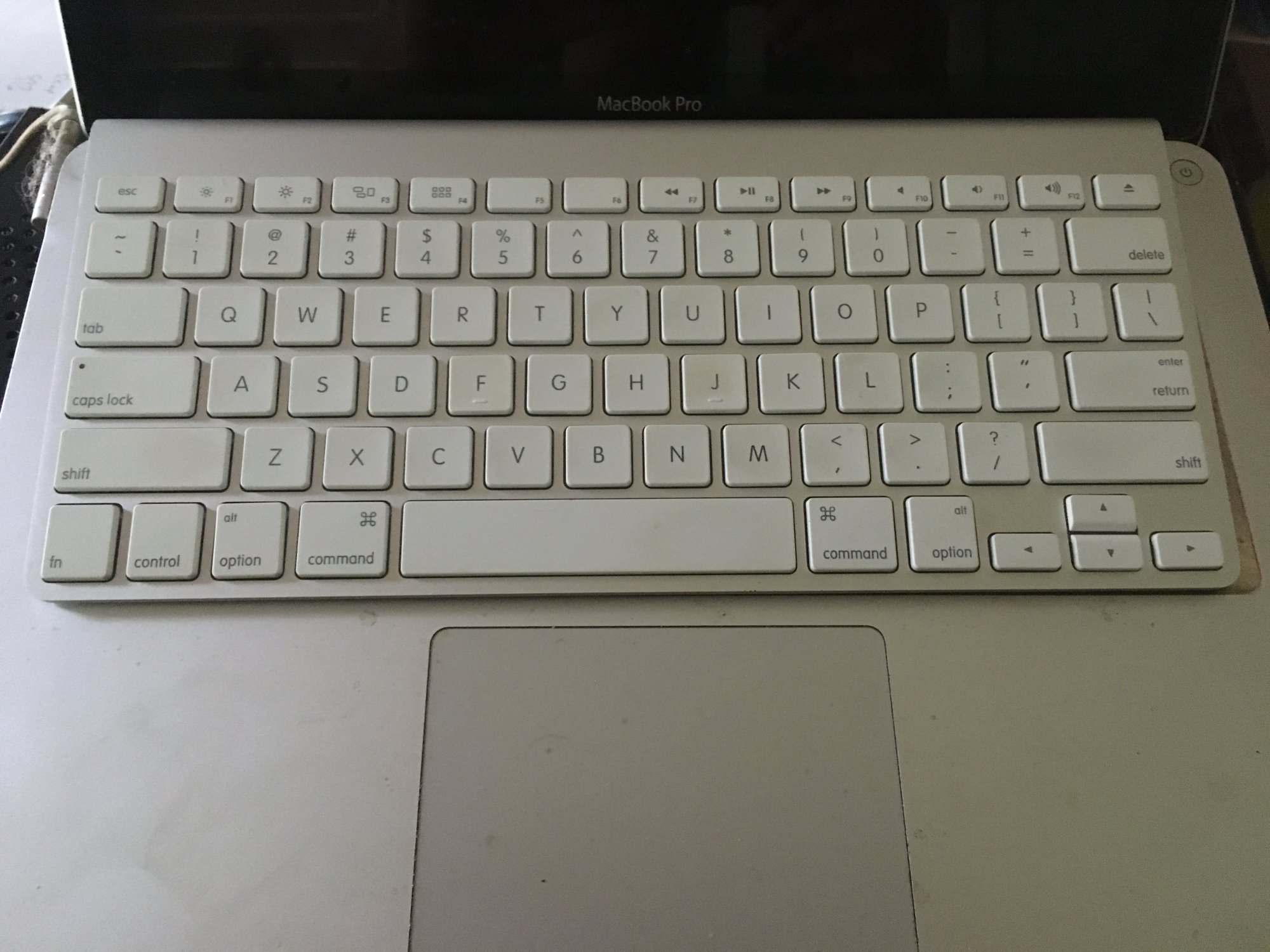

Keyboard failures like these, even if you’ve been assiduous and careful with keeping everything dry and clean ever since day one, are fairly common with the unibody MBPs (including even the later retina MBPs, whose keyboards are fairly similar).
On my own early 2011 13-inch, the i5/2.3, it is now on its third keyboard: the first failure happened within the first year of ownership (right when I was trying to finish a graduate thesis, no less), and Apple replaced the top case; the second happened three years later and I replaced that keyboard myself.

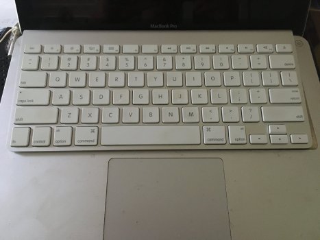

The kludge workaround, of course, is to connect a USB or Bluetooth keyboard, but that sort of undermines the utility of a laptop.
