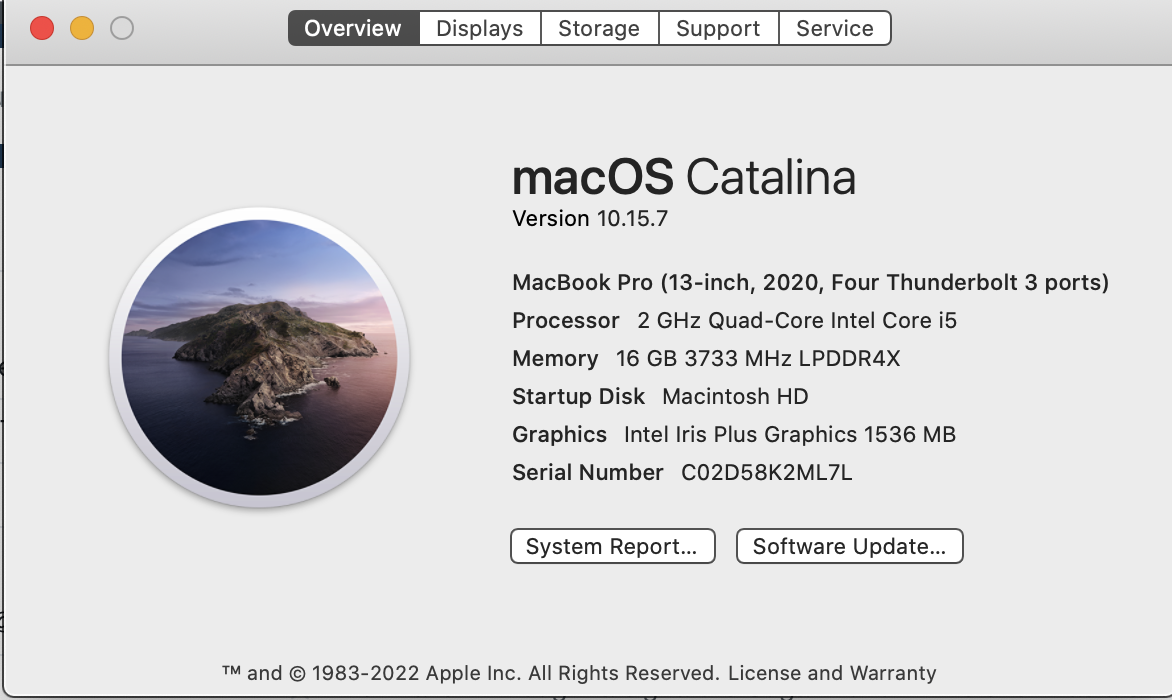

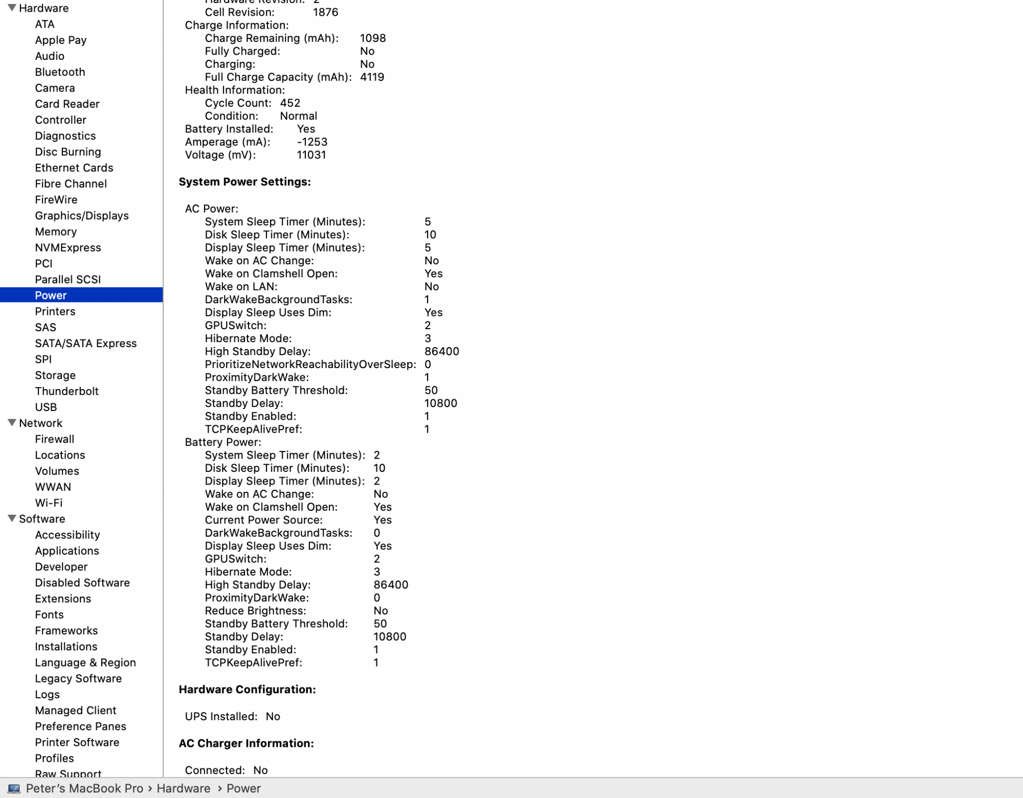

I've got a Macbook Pro 2020 running Catalina 10.15.7. My battery life seems horrible these days though it says its normal. I'm at 21% today after 2.5 hours of web browsing, which is typical for me lately. What's going on? I do keep the screen on brightest display so I can see it best, but other than that I'm not sure what could contribute to this. I've attached some screenshots that might be helpful.

452 cycles is likely the reason. apple says battery needs to be replaced at 1000 cycles. so you're halfway there.

Doesn't this mean I have plenty of cycles to go before I face trouble?
Not necessarily. Capacity just goes down as the cycles go by.

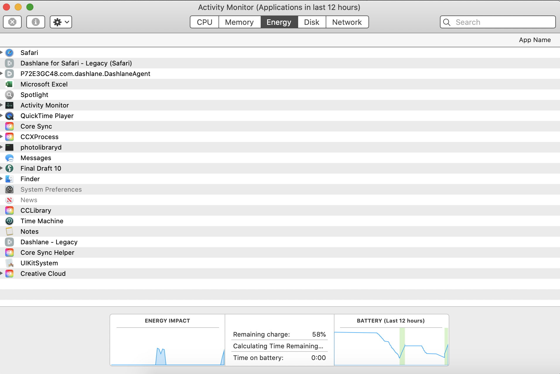

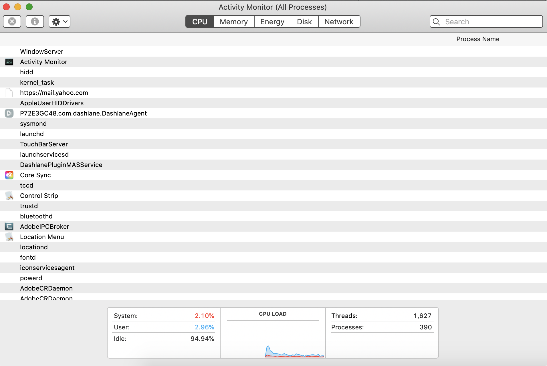

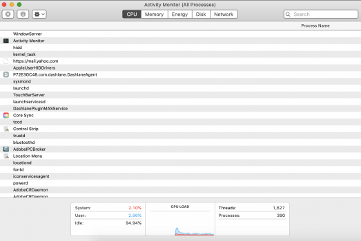

Here's what I see under those two tabs. I couldn't figure out how to sort CPU by time.

Your Activity Monitor screen isn't showing the numbers. You may need check View > Columns > Energy Impact and/or scroll to the right and put your pointer up by the light vertical bar on the same line as App Name, over to the right, and drag it over leftward to put the other columns where you can see them with the names. It should give a number for each to give you an idea how much an app is using compared to others.
