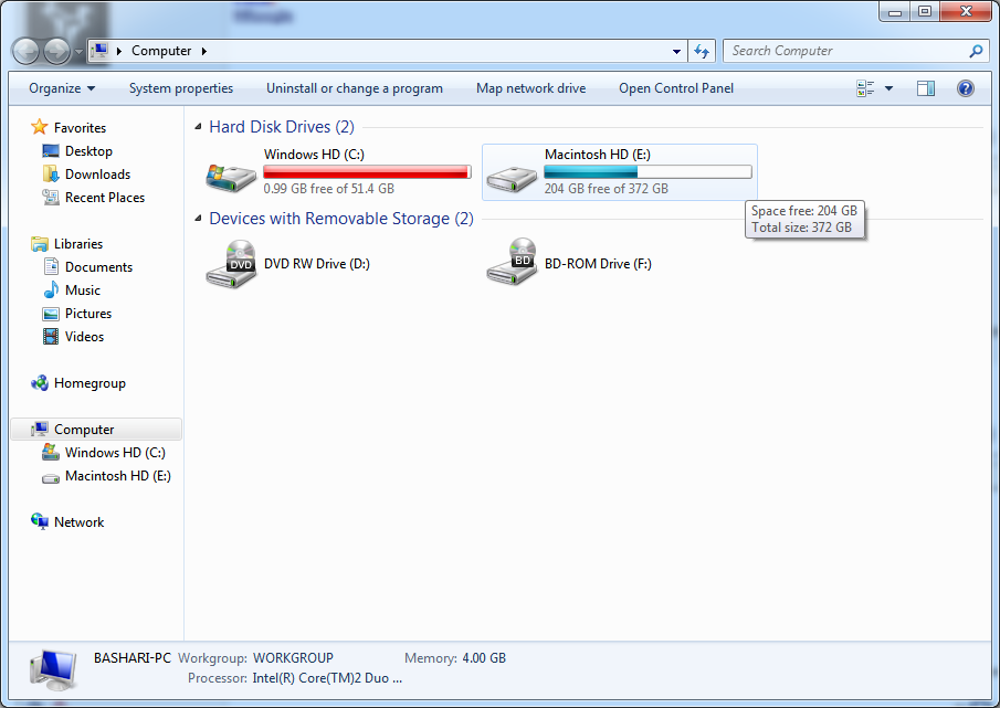

I was trying to resize my Windows partition using 'Ease US Partition Master' and I somehow ended up deleting my Mac OSX! Now all I have left is my Bootcamp Windows Partition.
However, in Windows, when I go to My Computer, all my files are still there in 'Macintosh HD'!! (see attachment)
But when I reboot my MB, and I hold ALT, only 'Windows' partition shows up
I'm REALLY confused here 😕😕
So basically my Mac partition is deleted, but my files are still there...
How can I restore my "Mac partition"
Note: when I start my MBP, I hear the 'apple sound' in the startup, but the apple logo never shows up
Note2: I don't have the Mac OSX CD, because my MBP is used, bought it from eBay and it doesn't come with the CD.
PLEASE HELP! thanks

reboot mac and hold CMD-R to go to recovery mode it takes a few minutes to load when your in recovery you will see disk utility see if disk utlity also sees and storage on your mac partition

try again you dont need OSX installed to get into recovery mode
when you hear the chime hold CMD and R
It sounds like the partitioner overwrote the bits of the disk that tell Mac what OSes are there to boot. That's not too surprising: it probably assumed it was a Windows computer. I _think_ reinstalling OS X from external media will cure the problem. It won't delete your existing data.
