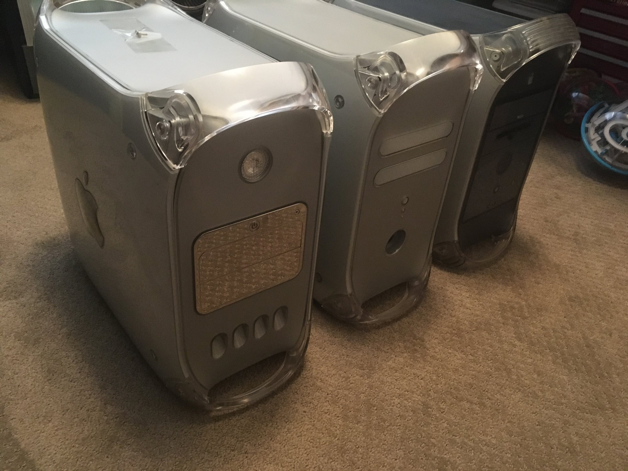

I got these computers two without hard drives or RAM and one fully functional on OS 9.1 (the server G4)
I have one QS and one MDD they need the ram and hard drives.

I would like to get them all in functional condition. I plan on running OS 10.0. I have the software. If anyone could recommend upgrades or anything about the rarity of any of these?
I’d like to find the best ram I can links?
Ps they are all for sale if you pay for them😉 no HD included.

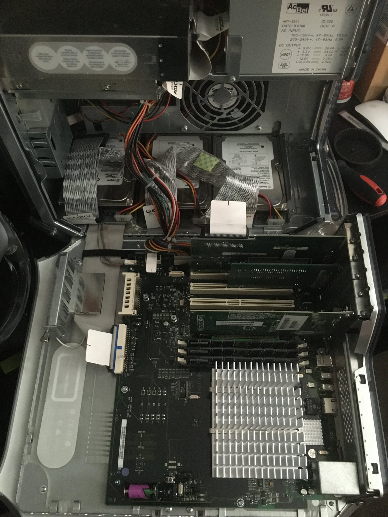

Your server has a "Jackhammer" SCSI card with 3 SCSI drives, or at least from what I see. This was a factory option and one of the things that made a server a server. In practice, you may find the 10K drives uncomfortably loud actually running. If you're going to use it, I'd suggest replacing them with ATA drives.
With all of that said, assuming your in the US, I'm partial to the Jackhammer set-up, and would be interested. PM me if you would like to sell that one.

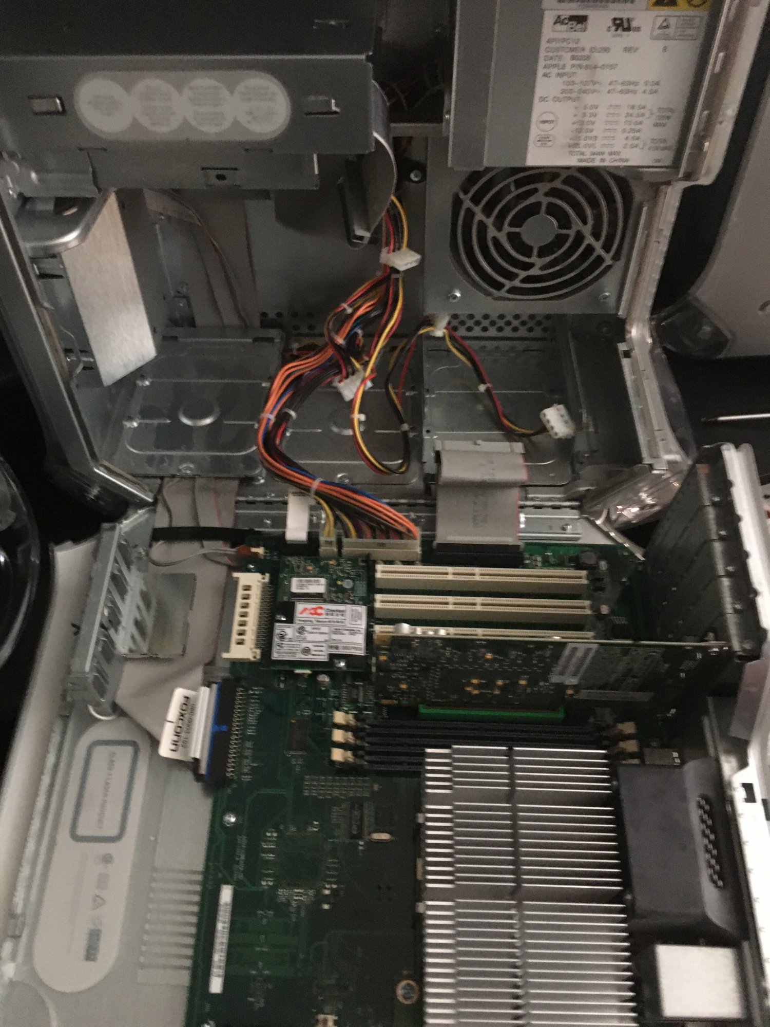

How can I get rid of the jackhammer and swap to a single drive?
Take the card and associated drives out. Put an IDE ribbon cable on the logic board at the bottom(same location as on the QS). Plug an IDE drive into it. You really want the little stubby ribbon cable like what's on the QS, as standard length PC one leaves you with a lot of cable bunched up that can impede airflow.

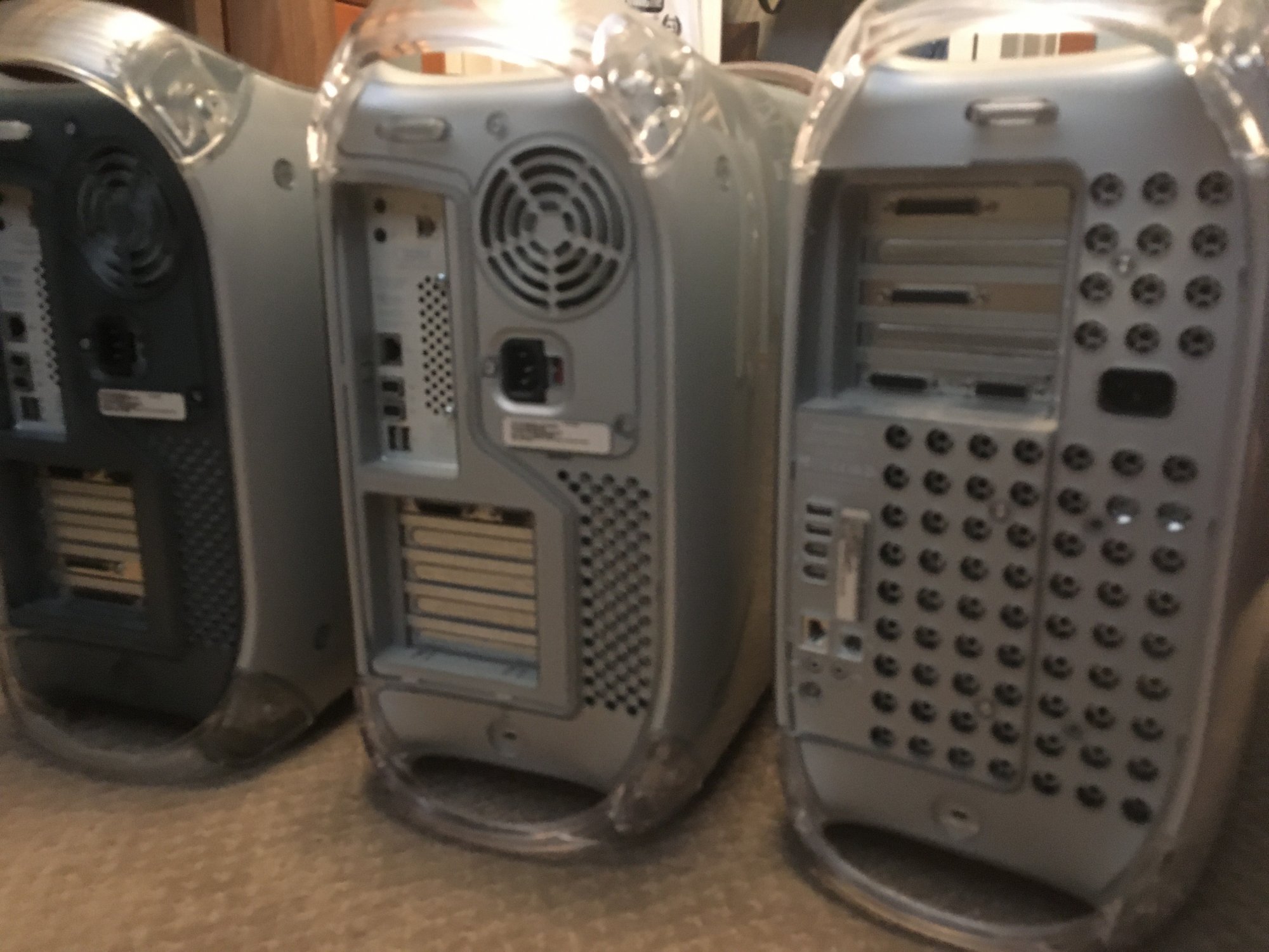

Which airports cards can each model run?
I know the da and QS are only airports. Can the mdd have an extreme?
I believe the FW800 MDD has an Airport Extreme slot, but the FW400 MDD have regular Airport card slots. One can get around those restrictrions though by either using USB WiFi sticks with modded drivers, or (much easier) getting an 802.11b/g PCI card which uses the correct chipset.

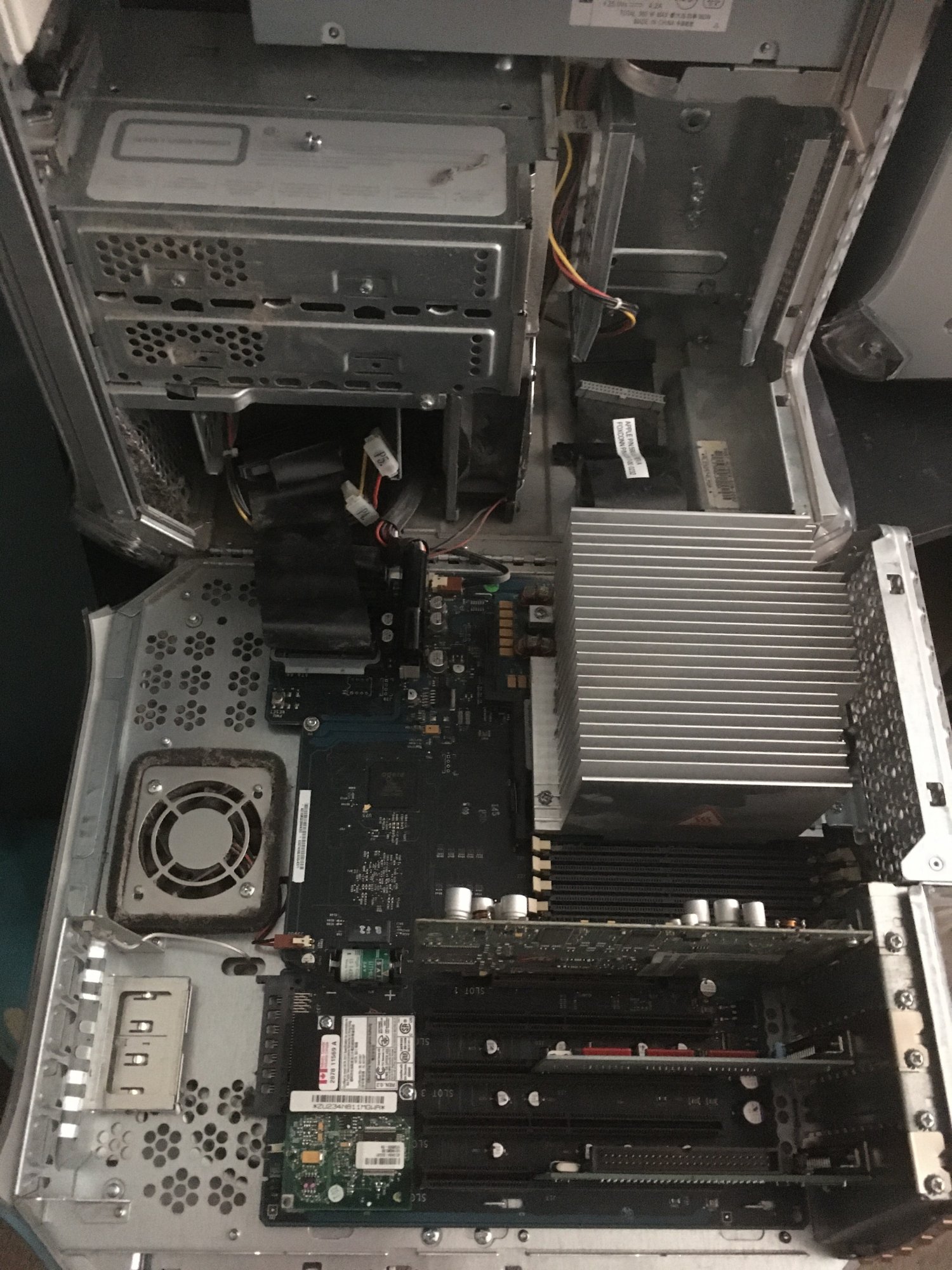

Just when to the recycle place and got ram for the mdd. Put it in and still no signs of life? Help?
Hmm Sounds like past PSU & logic board failures that I’ve experienced. IIRC pmg5s require matched sets but pmg4s do not. To check the ram, I’d try booting it with just one ram stick. If it boots, alternate from each stick to find the offending one. Take the bad stick back and swap it out. If it doesn’t boot, move into the PSU. An easy way to test psus is with a paper lip. Then move onto testing the power rail. Below is a good article on this.
