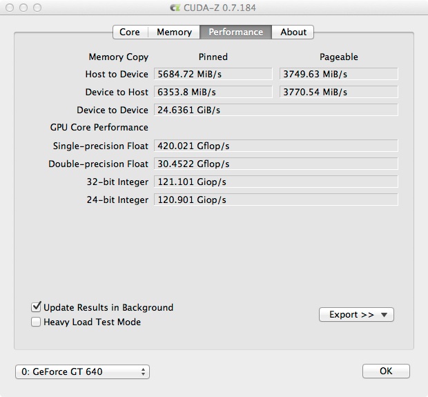

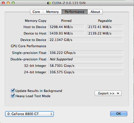

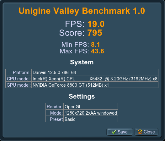

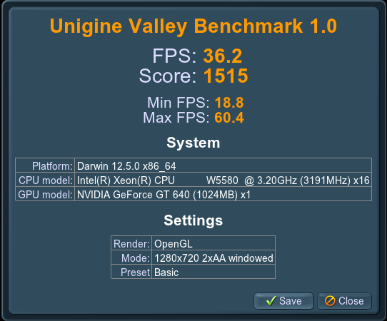

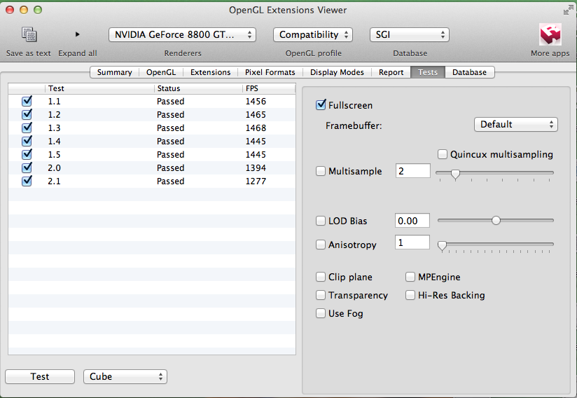

We have offered a GT640 EFI card for a couple months now.
I finally sat down tonight and ran it head to head with a 8800GT.
So, new entry level compared to 2008's High End.
The GT640 is 2GB of DDR3. The only GDDR5 cards I have seen at Newegg have had odd port combos. I picked this model to do because it has 2 @ DVI ports and an HDMI port. And it can run all 3 at once.
The 8800GT is Dual DVI only.
The GT640 doesn't need a power cable, the 8800GT does.
I will do a follow up with power consumption and OpenGl 4,1 tests from 10.9.
But, from my point of view, the GT640 kicks the 8800GT's butt.
No power cables means if you want more OpenCl on top of your 7970 or Titan, you just fill any remaining slots with 640s.
Only place the 8800GT won is in older OpenGl and this would be based on throughput/bandwidth.
Note that I ran the Uningine benchmark at "Basic" preset as either would have given slide show type performance in the "extreme" preset I prefer.
Wouldn't it be awful if your 2008 Mac Pro was STUCK in time using some outdated card that you couldn't replace? Fortunately, removable cards means you can bring your machine back into newer spec.
So, in 5 years top of heap is beaten by bottom.

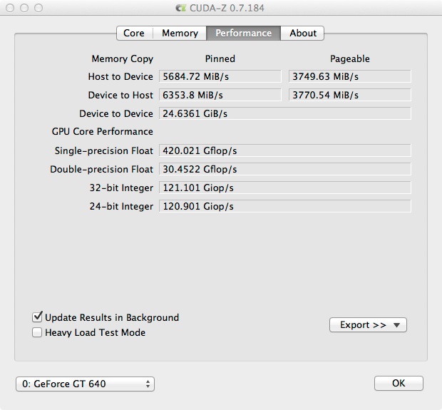

Gk208:
