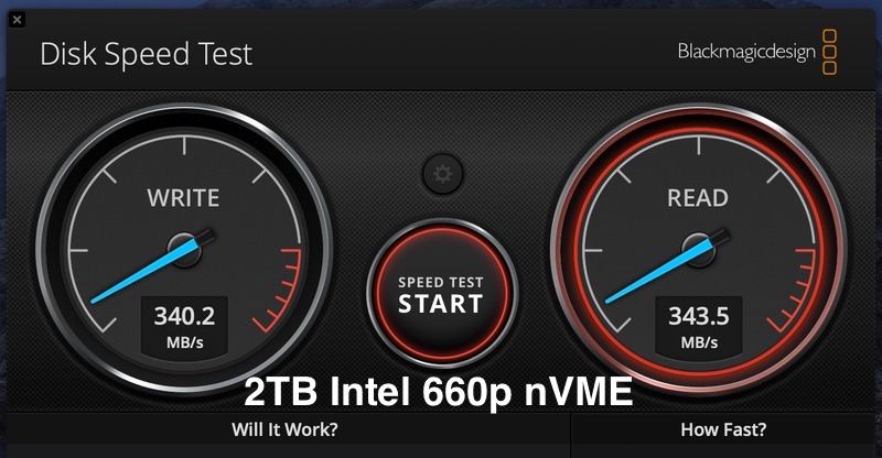

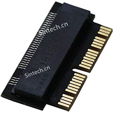

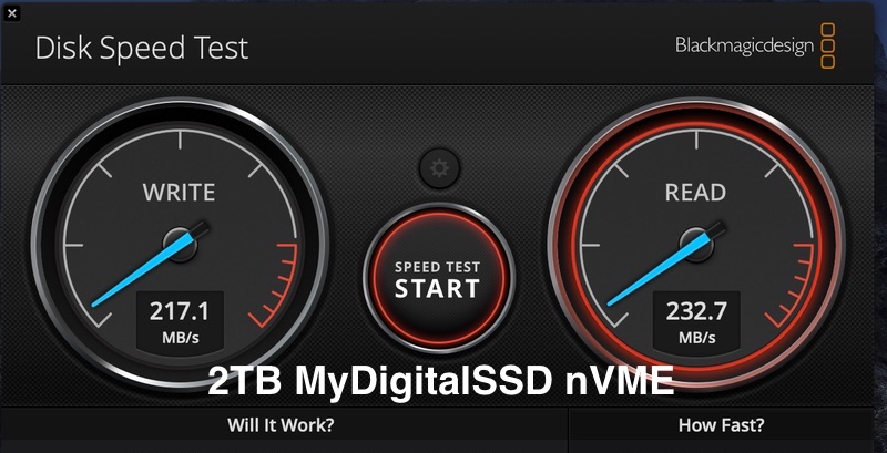

I upgraded the SSD on my recently acquired 2013 Mac Pro. First I ordered a 2TB MyDigitalSSD BPX Pro 80mm nVME and was getting about 217 MB/s write and 232 MB/s read speeds. I assumed this was due to issues with compatibility or an issue with the SSD so then I purchased an Intel 660p 2TB nVME drive and now I am getting 340 MB/s write and 343 MB/s read speeds. Any suggestions? Maybe its an issue with the Sintech NGFF M.2 nVME SSD Adapter Card? I have ordered a different brand that is awaiting delivery, QNINE M.2 NVME SSD Convert Adapter.

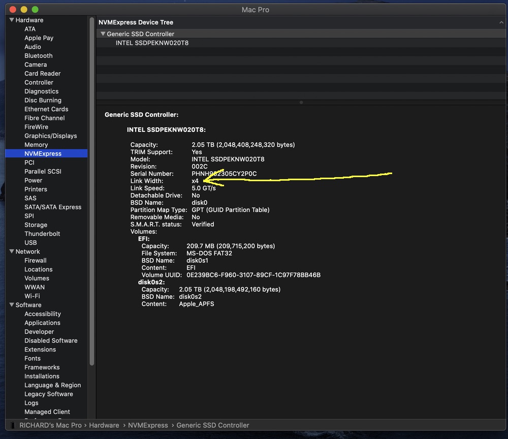

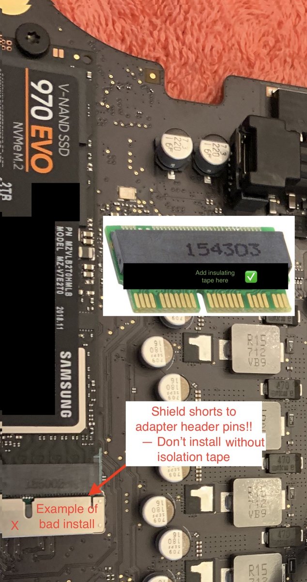

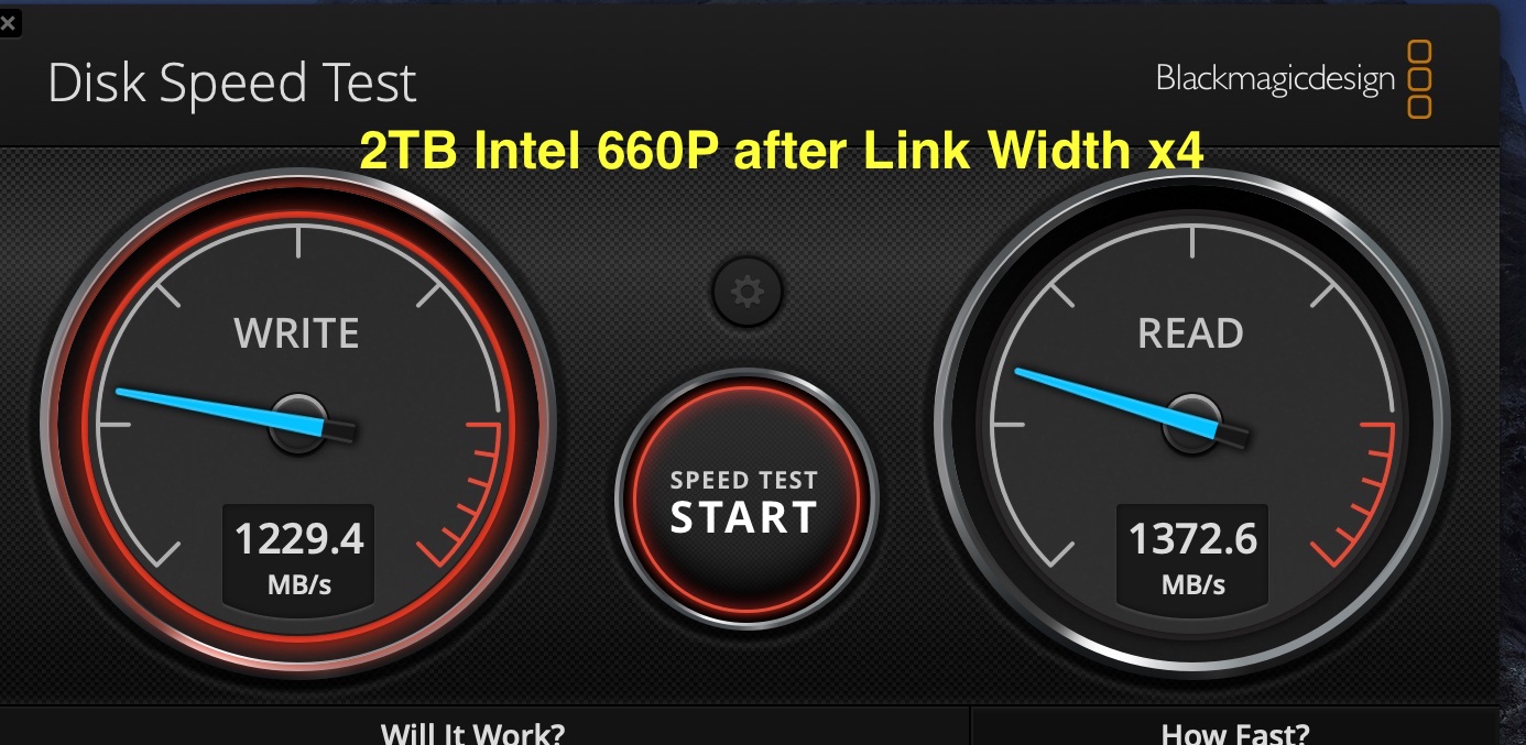

UPDATE: After poking around Google searches I ran across an article that talked about checking Link Width in System Report. Also found an article saying that these nVME adapters sometimes have an issue where the bottom edge of the connectors make contact with the metal strip along the top of the SSD socket on the Mac Pro. So first thing I did was check the Link Width and found that it was x1. I checked my MacBook Pro and found it was x4. Wow what a difference. I removed the SinTech adapter and checked the protection tape which looked ok. Long story short, I played around the tape placement and got the link width to x2, then messed around with it some more and re-seating everything and now the Link Width is x4. The speed results are pretty much 4x faster now than before. I have a different brand/mfg adapter coming tomorrow so will try that one too.
