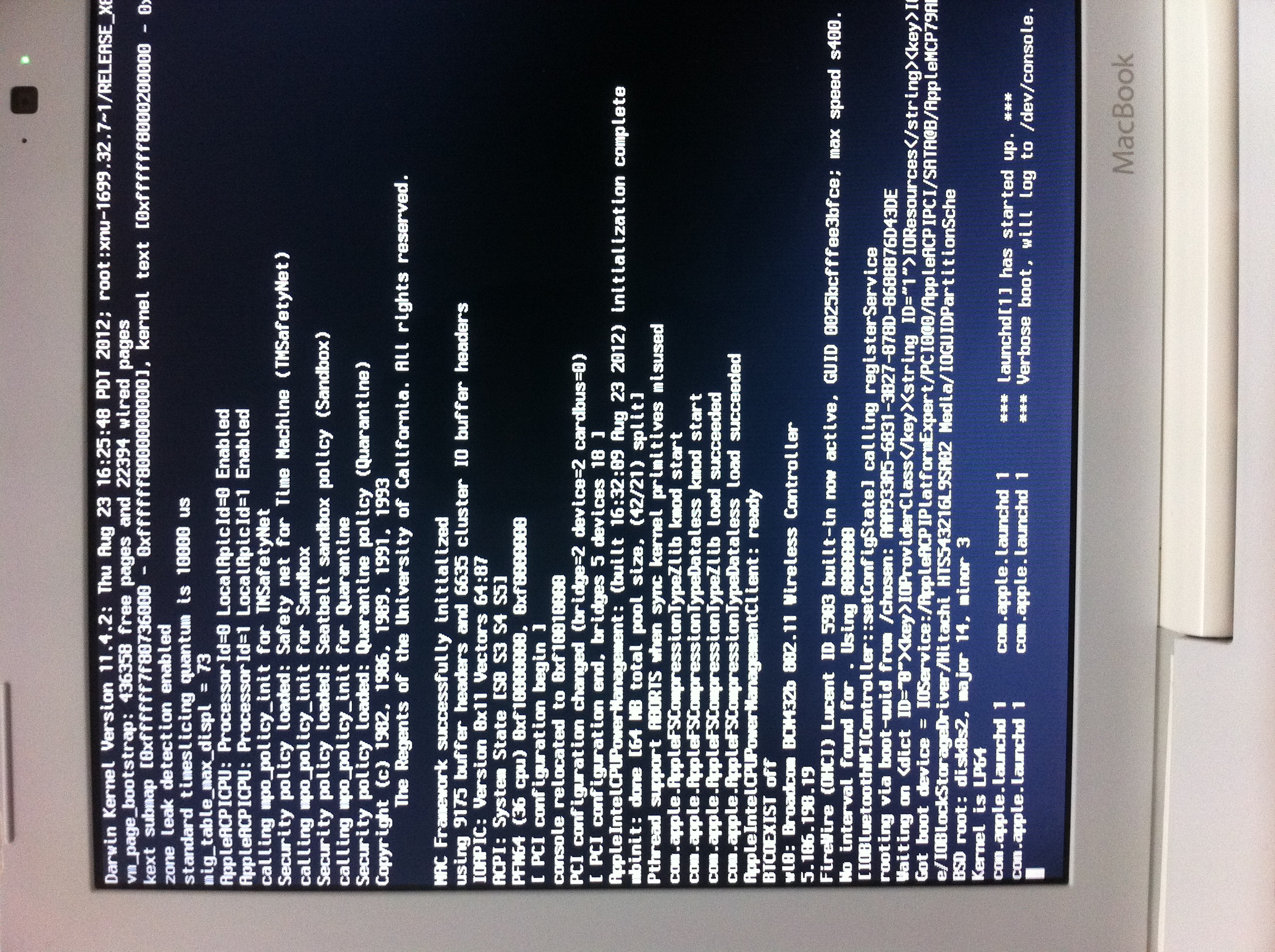

Tried Verbose mode and after the whole test shuts down (you can see the screenshot just before it shuts down)

I didn't download the screenshot, too big but from what I could see it recognises the HD but as soon as it start reading from it it stalls.
