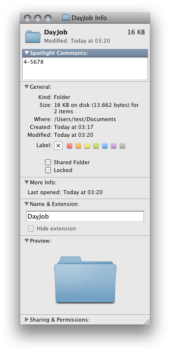

I think you can execute bash script in those workflows. If this is correct then execute a bash script that greps the file for the 3-job number or have that set as a variable it passes to the bash script when it executes a cp /path/to/my\ jobs\ folder/file-job\ number\ variable.pdf on each file as it is processed by the workflow.
…but I'm not sure how I would be able to do the appending. Any ideas of a workflow or a separate application that could accomplish this?

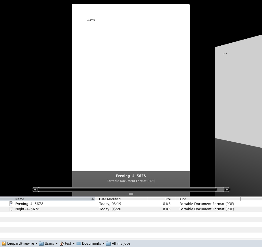

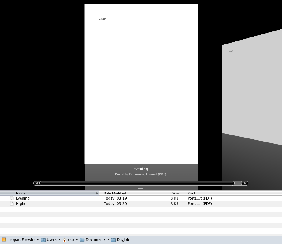

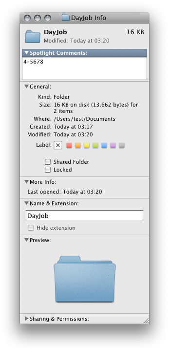

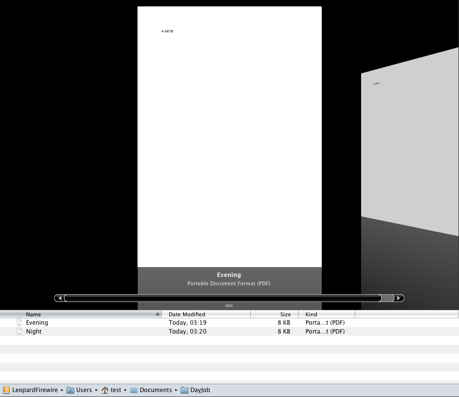

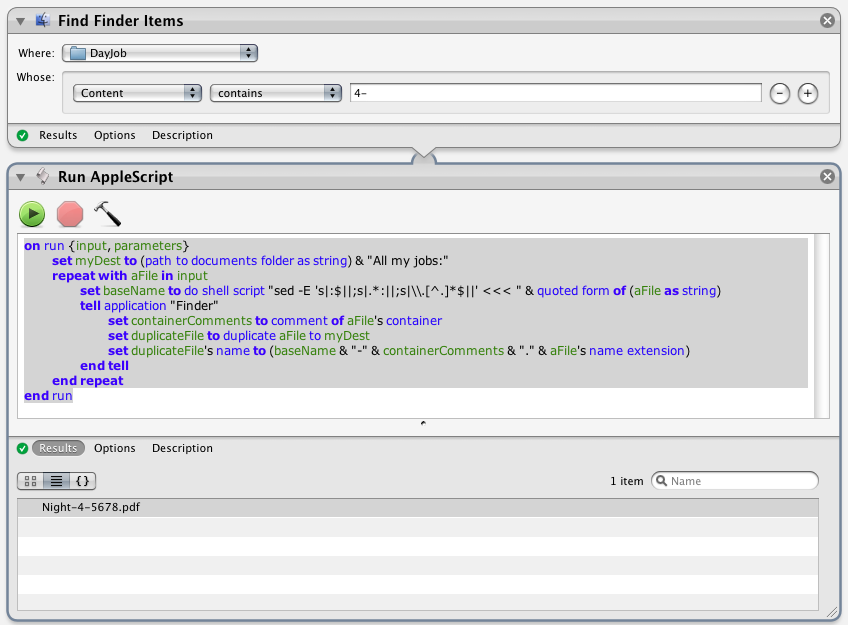

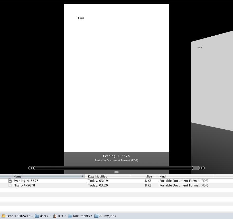

You can replace your Copy Finder Items action with a Run Applescript action and replace the default code with this :
Code:
on run {input, parameters}
	set myDest to (path to documents folder as string) & "All my jobs:"
	repeat with aFile in input
		set baseName to do shell script "sed -E 's|:$||;s|.*:||;s|\\.[^.]*$||' <<< " & quoted form of (aFile as string)
		tell application "Finder"
			set containerComments to comment of aFile's container
			set duplicateFile to duplicate aFile to myDest
			set duplicateFile's name to (baseName & "-" & containerComments & "." & aFile's name extension)
		end tell
	end repeat
end run
Note : As you can see it expects your "All my jobs" folder to be located in your Documents folder. If that's not the case change the myDest line to where your "All my jobs" folder is located in the form of a Mac path eg.

Holy cow! Thanks a lot! That's so helpful. I tried inserting the code you gave me, but when I run it, Automator gives me this error:
The action “Run AppleScript” encountered an error.
Check the actionʼs properties and try running the workflow again.
If I try to just run the Applescript, it gives me this error:
Syntax Error
Can’t make «class ctnr» of item 1 into type reference.
I had edited the location of the folder to what I thought it should be, but perhaps I'm doing it wrong. The drive I'm trying to save to is a external drive on our (Mac) server that is shared with me (i.e. I have read/write access). Here is what I put into the Applescript you wrote:

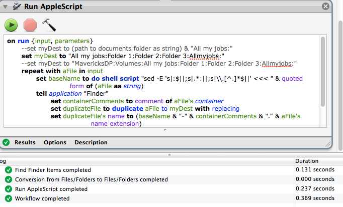

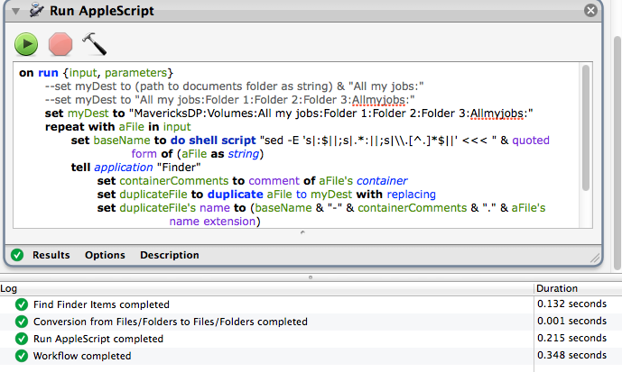

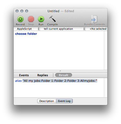

Sure. As you have noticed the set myDest to "" isn't correct in your case. The best way to get your correct path to your folder would be to launch the Appescript Editor application and paste in the following :
Code:
choose folder
Click the Run button and in the Choose a Folder window that pops up navigate to your Allmyjobs folder on your server. Look at the result pane (see thumbnail) to see the path it returned in the form of an alias. That's the path you need.
In my example I used a shared folder "All my jobs" I shared via AFP on my Mac mini. The result I got when running choose folder was this :
Code:
alias "All my jobs:Folder 1:Folder 2:Folder 3:Allmyjobs:"
As you can see I used "All my jobs:Folder 1:Folder 2:Folder 3:Allmyjobs:" but you can also use "MavericksDP:Volumes:All my jobs:Folder 1:Folder 2:Folder 3:Allmyjobs:" where MavericksDP is the name of my local hard disk.(e.g. the name of the disk of the mac from where you are running your workflow) Yours will probably be different so if you want to use that form you will have to change it!
Note : I hope it's a little clearer now. There is no error trapping in the script meaning it assumes the server is up and the folder is available. I'll try to make it more robust when I have some time to spare.
Code:
choose folder
Code:

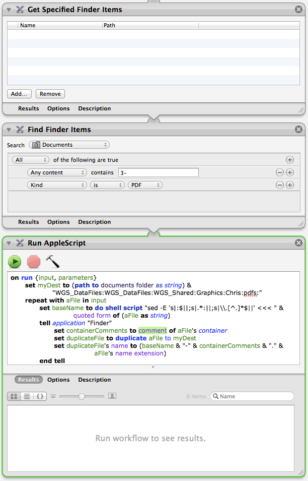

Thanks again for your help. It still isn't working. I'm still getting the "Syntax Error/Can’t make «class ctnr» of item 1 into type reference" message.
I've uploaded what my Automator app looks like now. (The Get Specified Finder Items part Automator told me needed to be there while I build the app, but once I finish, I believe I can delete it before saving.) You can see exactly the file structure I got when I ran "choose folder" in the Applescript editor.
Perhaps one reason it isn't working right is because I'm accessing the shared drive differently than you? I'm not sure what the terminology is for how I'm accessing it– I've asked someone and will update this post with the proper terminology. I have included a screenshot of how my Finder looks. I mount the drive by going to Go:Connect to Server in Finder and it shows up under Devices instead of Shared in my Finder Sidebar, though the address has AFP in it...
Does this change anything at all?
I REALLY REALLY appreciate the help. It'll make some things around my office easier if I can get this to automate. HOWEVER...Feel absolutely free to withdraw helping if/whenever you'd like. I don't expect you to help me endlessly with this. Thanks.
  1. Is this a service? The first action is clearly receiving input from something. You don't need the Get specified finder items action. Start with a simple workflow in Automator with 2 actions. The Find Finder items and the Run Applescript action.
  2. Please remove the (path to documents folder as string) & part from the set myDest line!!!!!
  3. I don't see any output or tumbnail from the "choose folder" in the Applescript editor in your post.
  4. Please do not forget to do step 2 in the list. You absolutely need to have the correct path to that folder.
  5. Start with a workflow first that way you can run it from within Automator. If everything works as it should you can then save it as an application!
  6. I know I'm starting to sound a bit like a drag but if it's still not clear by now that you need to remove the (path to documents folder as string) & part from the set myDest line then you can also remove the line completely and replace it with this :
    Code:
    set myDest to (choose folder) as string
Looking at you tumbnails i think this would be the correct path :
Code:
set myDest to "WGS_DataFiles:WGS_DataFiles:WGS_Shared:Graphics:Chris:pdfs:"
