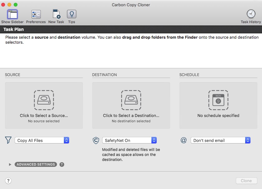

Let's try something else:
1. Download CarbonCopyCloner from this page:
CCC is FREE to download and use for 30 days (trying this costs you nothing)
2. Open CCC (while booted from the external drive). Accept the defaults for now.
3. Get to the main window (the one with "3 boxes"). It looks like this:
4. Click on the "leftmost" box. This should produce a popup menu with a list of drives. Do you see BOTH the external and internal drive?
We need to know the answer.
If you see the internal drive, then it's probably "clone-able".
You will need a SECOND external drive.
Then run CCC again, put the internal drive on the left.
Put the SECOND external drive (which will become the target) in the middle.
Leave the right box alone (that's for scheduling, not needed).
Then, you "clone" the contents of the internal drive to the external.
But again, we need to know if CCC can see the internal drive.
If it can see it, it can probably "clone" it as well.
Once you get the data onto an external drive, it may then become "reachable".
If it's "reachable", it may be "recoverable".
Do this stuff, and get back to us.
