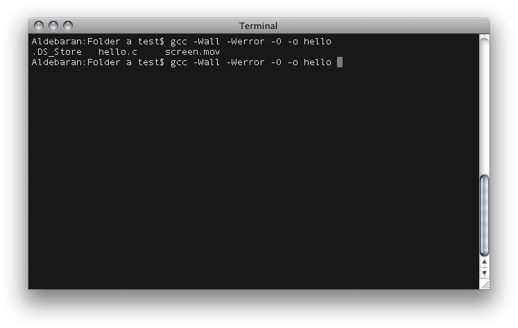

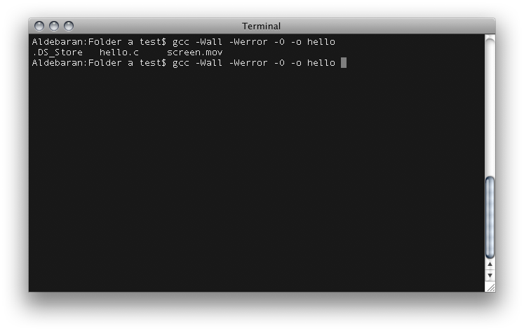

Open Terminal and cd into your directory where your .c file is and type :
Code:
gcc -Wall -Werror -O -o hello
then press tab to see if you see your hello.c file. If you do see it press h and tab again. Bash will autocomplete.

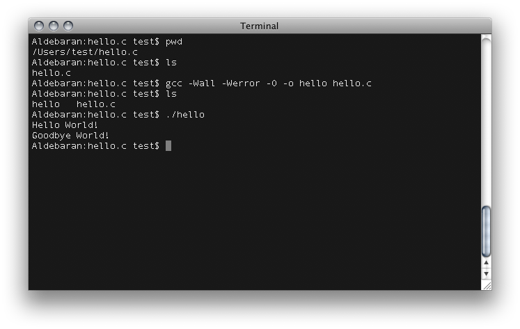

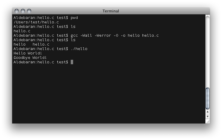

balamw asked for the result of the pwd command. The result will be a POSIX style path using the slash / as the separator for directories eg /path/to/some/folder.
Example :
/Users/test/Desktop/hello.c
