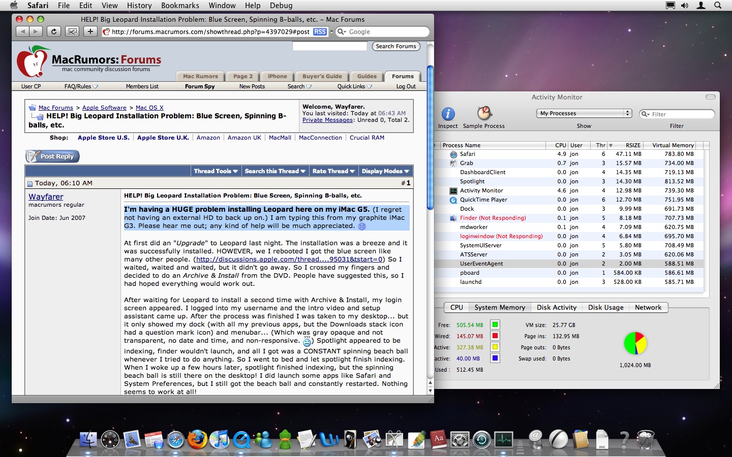

I'm having a HUGE problem installing Leopard here on my iMac G5. (I regret not having an external HD to back up on.) I am typing this from my graphite iMac G3. Please hear me out; any kind of help will be much appreciated. 🙁
At first did an "Upgrade" to Leopard last night. The installation was a breeze and it was successfully installed. HOWEVER, we I rebooted I got the blue screen like many other people. (http://discussions.apple.com/thread.jspa?threadID=1195031&tstart=0) So I waited, waited and waited, but it didn't go away. So I crossed my fingers and decided to do an Archive & Install from the DVD. People have suggested this, so I had hoped everything would work out.
After waiting for Leopard to install a second time with Archive & Install, my login screen appeared. I logged into my username and the intro video and setup assistant came up. After the process was finished I was taken to my desktop... but it only showed my dock (with all my previous apps, but the Downloads stack icon had a question mark icon) and menubar... (Which was gray opaque and not transparent, no date and time, and non-responsive. 😕) Spotlight appeared to be indexing, finder wouldn't launch, and all I got was a CONSTANT spinning beach ball whenever I tried to do anything. So I went to bed and let spotlight finish indexing. When I woke up a few hours later, spotlight finished indexing, but the spinning beach ball is still there on the desktop! I did launch some apps like Safari and System Preferences, but I still got the beach ball and constantly restarted. Nothing seems to work at all!
As much as I've been anticipating Leopard, this is very disappointing. Any help much appreciated... 🙁
I'm having the same problems. I can't figure out how to fix it. I might have to run up to the genius bar and see if they can figure it out.
Most stuff is still unrepsonsive, but I'm now able to use Safari and other apps. Here's a breakdown of my problems I found so have:
  • 😡 -Finder will NOT launch!!! It's unresponsive every time. This is not good. I can't see my files unless I use the "open" dialog in another application.
  • 🙁-Can NOT log-out!
  • 🙁-Right clicking on dock causes endless spinning beach ball and locks up my mac
  • 😕-No date and time
  • 😕-Software update doesn't give me correct updates
  • 🙁-Some system prefs cause endless spinning beach ball
  • 😱-Menu bar is opaque, not transparent
  • 😡-Spaces, front row won't launch
  • 😱-Stacks, dashboard, and most apps work fine
  • 😎-Spotlight works, and FAST!
I am relieved to see that all of my files of intact, but all in all, there's not much I can do with these constant spinning beach balls here and there and NO finder. I'll keep everyone posted.
Help anyone? 🙁

I got the blue screen problem too, but I fixed it with an archive and install. THEN I got welcome screen to load but my then by finder disappeared and beach balls popped up everywhere. BUT NOW... someone had a mentioned my same problem in another thread and a SOLUTION! Whoo hoo!!
M
https://forums.macrumors.com/showthread.php?p=4397333
Much thanks to Mac Rumor's member Chupa Chupa! One quick fix, NOW EVERYTHING WORKS PERFECTLY! 😀😀😀
Anyone else who has an unresponsive finder, I highly advise you to check out the fix above. :🙂 😎

But, if I'm getting the blue screen problem at login, will I need to do an archive/install on the same disk first, before doing that fix?
Yes, archive/install again, reboot, login into your username, get the welcome screen... and you might be ready to go.
HOWEVER, if your finder won't launch, wait for spotlight to reindex, then use the fix above. Everything should start working again.
