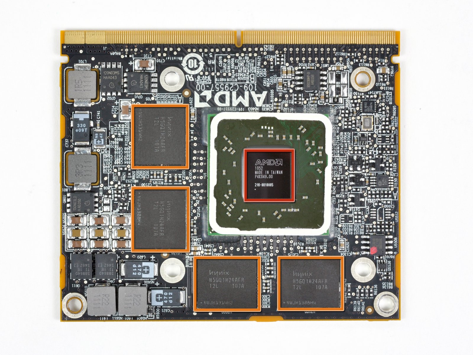

also; long shot, check the video card. Imac 12,1 are the last models that have discrete graphics (via MMX) so an experimenting upgrader may have left it with an incompatible card. It should be an AMD Radeon HD 6750M or 6770M, with 512MB VRAM. if I read everymac correct, there was an EDU 12,1 with only 256MB VRAM (maybe only 2 SDRAM chips instead of four) like shown in this teardown photo... - i'd suspect EDU version is pretty low on the compatibility ladder of things.

To follow up on my post above, the 2011 27" iMac I got had the 6790 board, and would try to boot and fail at above 50% on everything - Internet Recovery, or a USB. It would look fine, and then go to gray screen (and freeze). I was able to load an ASD disk, EFI only, and it found no fault with the logic board or GPU or HDD. Given the GPU issues with the 2011, I went ahead and bought a GTX 675 (Alienware), and used another mac to install High Sierra on the HDD (a Windows only tech had installed Windows10 on the main partition). Put it back together, and it booted with zero issues.
jimbob200521, this sounds a lot like your issue. The way I looked at it, if the new gpu board didn't work, I could recoup at least 75% of the price reselling it on eBay, so it was a reasonable gamble. I'm not excited about ever removing that logic board again, though.
Reactions: Beachguy
Sorry for the lack of responses guys, I haven't had much time to play with this thing since I got it. I have taken the information given and did some looking. Would what is linked below be a viable option if my issue is indeed a video card problem? Seems like $50 for a replacement video card wouldn't be a bad option...
https://eshop.macsales.com/item/Apple/6615994/
