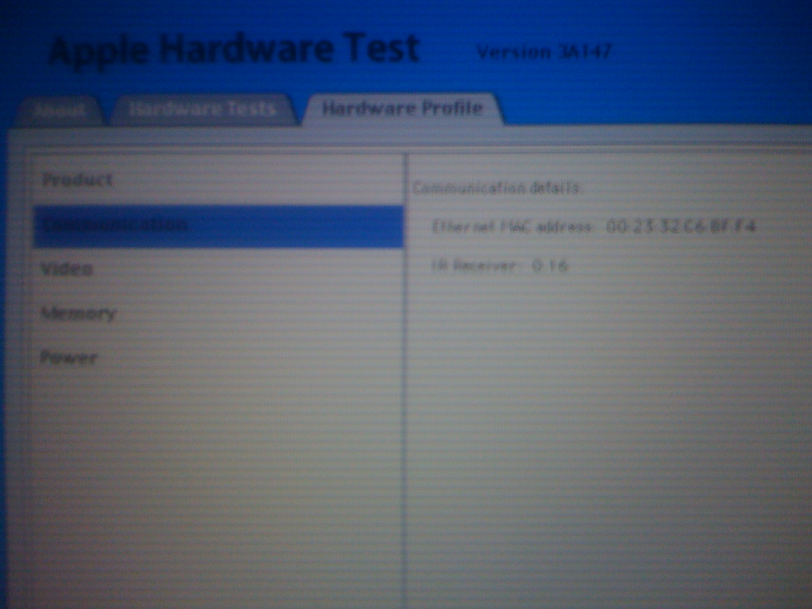

MB466 bought on january, running mac os 10.5.7, got a problem on LCD so i sent it to dse, where i bought it from, for repair. i have receive it today and the LCD was replaced and work perfectly.
But the problem is, i have found i cant connect to internet via wireless because the airport was set off and i cant turn it on. i have search on google for a way to do it and somebody said i just delete airport in network setting and add it again will turn it on. i tried, i delete it, and i cant add it back any more.....
i tried all the possible way except reinstall mac os and found no use because my macbook totally dont recognize the airport.
im getting really crazy on this.....Please someone help me....

it not even recognise airport
form 'about this mac - more info - airport card' it shows 'no information found'
i tried to delete the preferences file and no use

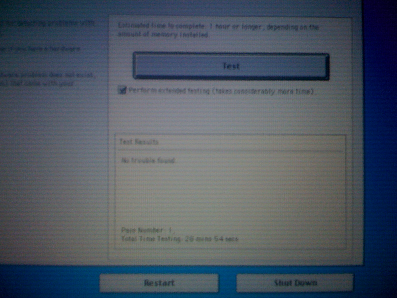

i also did an apple hardware test and i believe it is a hardware problem that i may need to send to shop for repair
i have taken some picture and it is form iphone so it is quite hard to see
for apple hardware test, it did said no problem found, but i found form communication, there are only ethernet's mac address and bluetooth(IR receiver) and no airport

Now I understand.
And yes, you should bring your MB back to the repair service, as they seem to have fracked something up.
It's also nice to see, that the Hardware Test still uses a pre-OS X UI.
