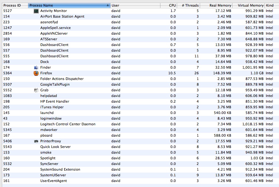

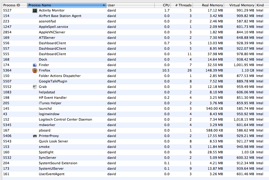

Wow I had no idea i had so many things running. There are probably many I don't need. I hope this can help you identify the "mystery" program. If you or anyone else has any suggestions as to what i should or should not have running, any advice would be greatly appreciated. Also where I would remove them from being restarted when i reboot.
You're only showing "My Processes". Find where it shows "My Processes" and switch it to "All Processes", then repost the screen caps.

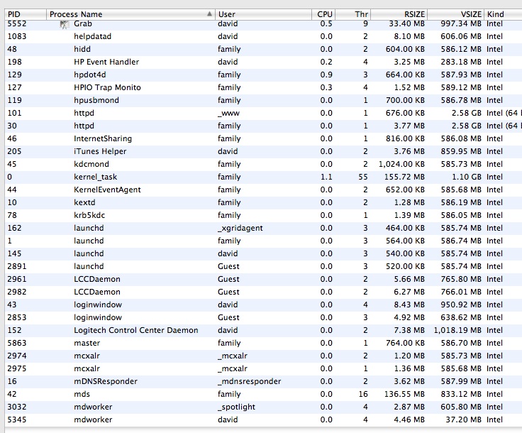

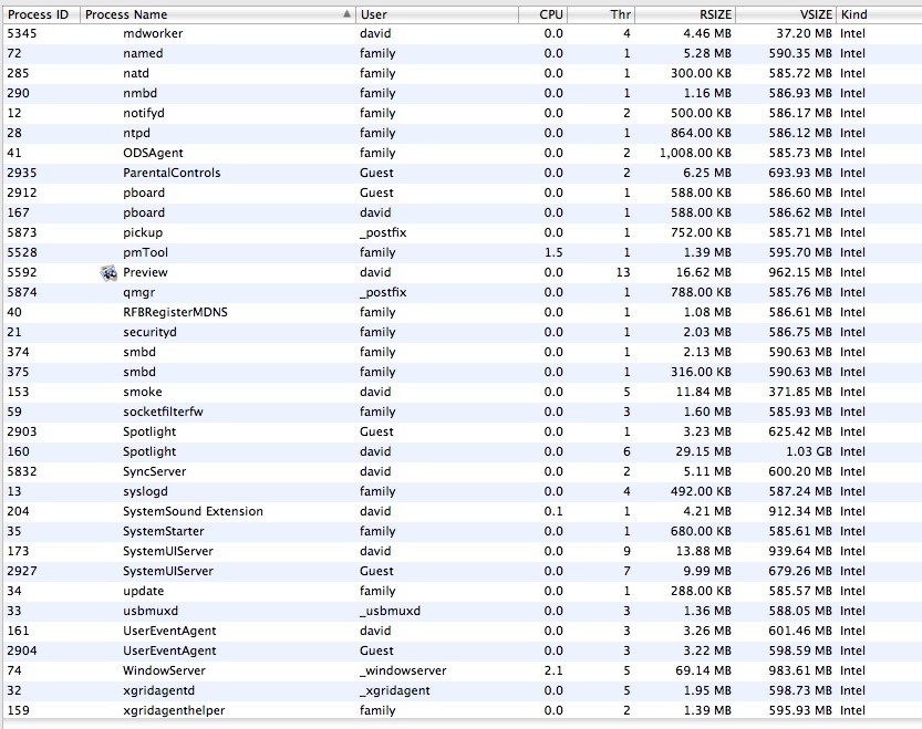

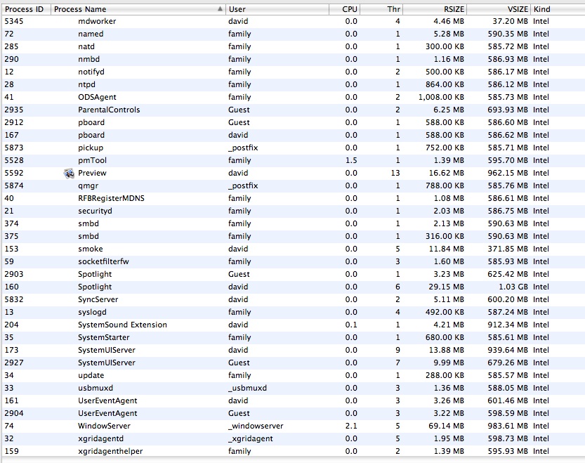

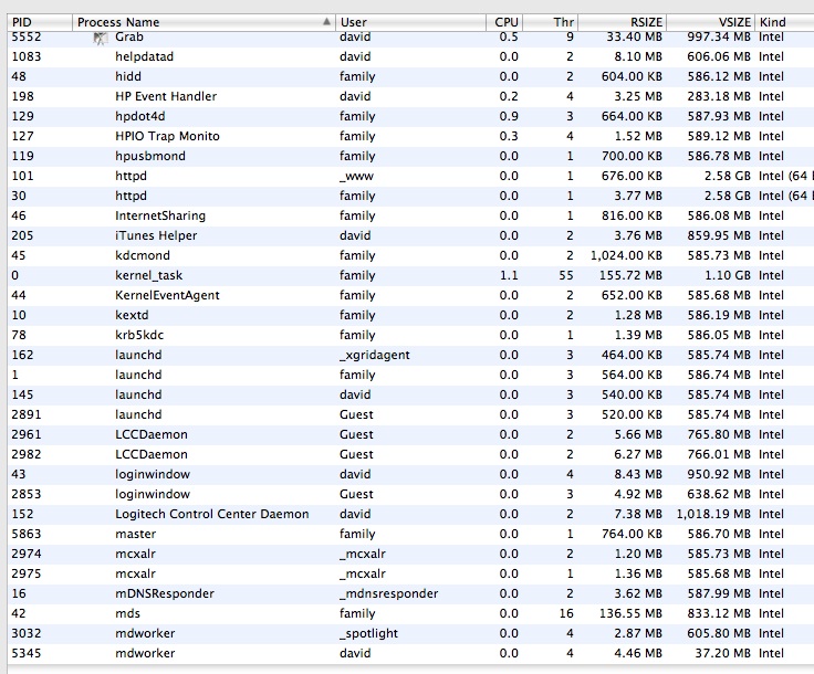

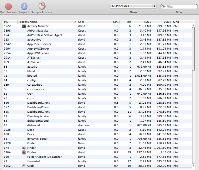

Here is ALL of the processes running...
There are 3 pages of processes running is that the way it is supposed to be?
Yes, it's perfectly normal to have that many processes running. Most are components of Mac OS X and the applications and widgets you have running. I don't see anything on the list that stands out that might account for that icon.

You can also try killing various processes until you identify the one responsible for the icon. If you kill a process that controls the icon, the icon should disappear. You probably won't be able to kill any process critical to Mac OS X, but if you do, the worst that can happen is your Mac will shut down. Simply reboot and continue the process until you've identified the process responsible for the icon. Before you start this procedure of killing processes, make sure you've closed any apps you have running, so you don't lose any work you might have open.
I didn't take the time to look up all processes and I don't recall them all from memory, but you could start by killing the following:
Grab
HP Event Handler
HPIO Trap Monitor
master
mcxalr
smoke
xgridagentd
xgridagenthelper

OK that worked when i quit a process called smoke it disappeared. when i rebooted it was running again. It does not appear when i go to account start-up processes. How do I get rid of it forever. Also whenever i open Google chrome ,it flashes that about blank is starting is there a similar way to rid myself of that? I love Chrome but don't use it because of that. Thanks SO MUCH for all your help.
