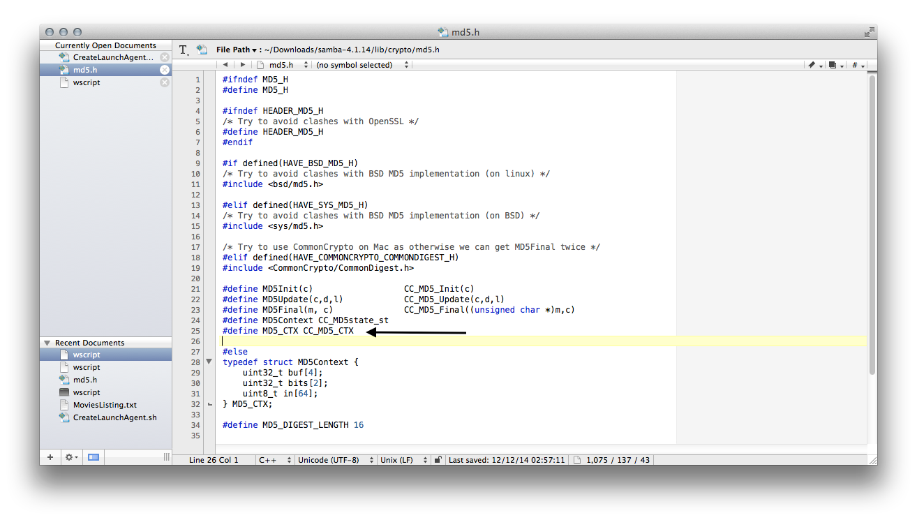

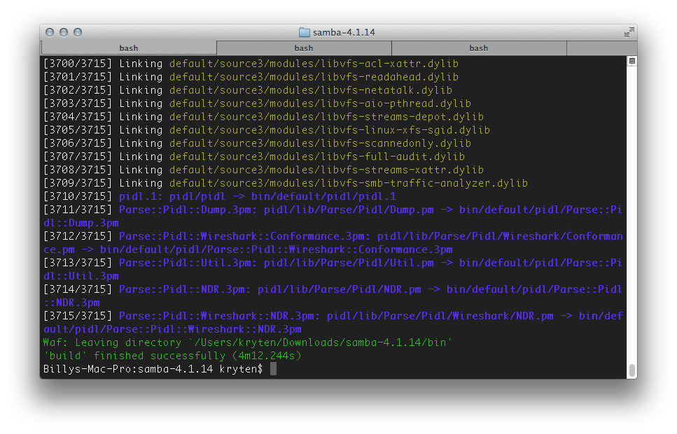

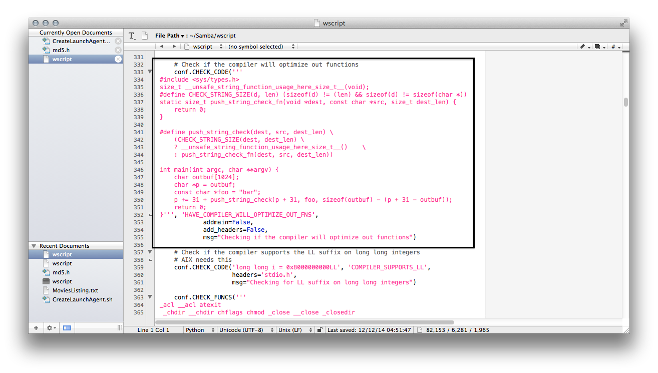

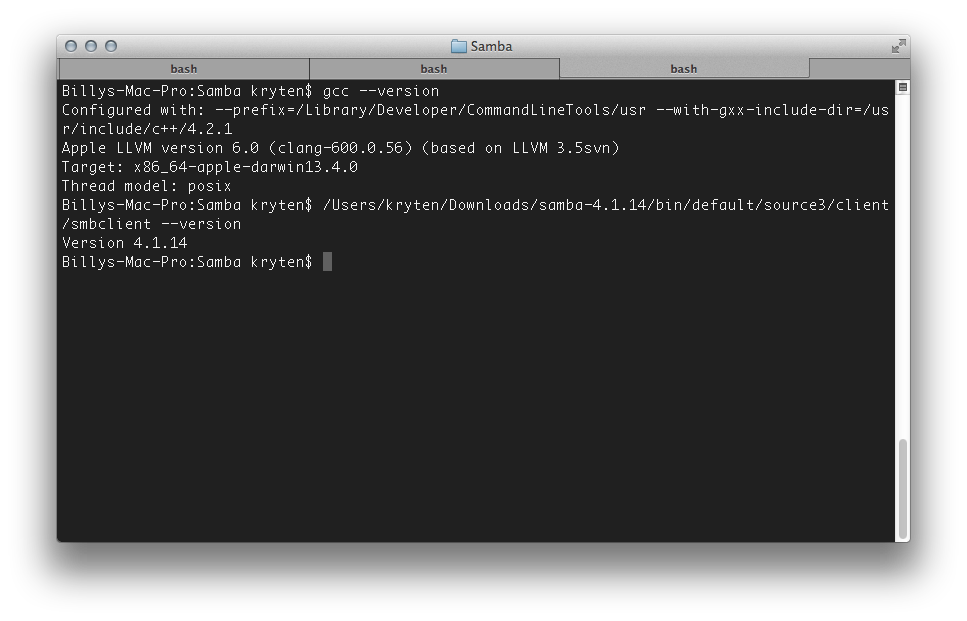

You need to patch 2 files to compile samba-4.1.14 on OS X 10.9.5. If you unpacked the samba-4.1.14.tar.gz file you'll have a samba-4.1.14 directory.
In the example given ~ stands for /Users/username.
Files to patch :
  • ~/Downloads/samba-4.1.14/lib/crypto/md5.h
  • ~/Downloads/samba-4.1.14/source3/wscript
Info : https://trac.macports.org/ticket/38834 - https://lists.samba.org/archive/samba-technical/2014-October/103018.html
Note : You can use the patch command in Terminal to patch the files or make the changes with a text editor.
Code:
Billys-Mac-Pro:Samba kryten$ patch -b wscript patch.diff
patching file wscript
Hunk #1 succeeded at 331 (offset -18 lines).

Thanks, I'm almost there.
My last question is regarding the content of the text file "patch.diff" I assume I have to create in the /samba-4.1.14/source3/ directory.
Exactly what part of the second half of the linked message from the Samba Archive has to be in the file?
Thanks again! I'm sorry if I'm not seeing the obvious beginning and end of the actual patch.
I've tried the folllowing, placed the patch.diff in the /samba-4.1.14/source3/ directory
Content patch.diff
Code:
 source3/wscript | 26 +++++++++++++++++++++-----
 1 file changed, 21 insertions(+), 5 deletions(-)
diff --git a/source3/wscript b/source3/wscript
index 4f182bf..2083f01 100644
--- a/source3/wscript
+++ b/source3/wscript
@@ -349,12 +349,28 @@ int main(int argc, char **argv)
     # Check if the compiler will optimize out functions
     conf.CHECK_CODE('''
-if (0) {
-    this_function_does_not_exist();
-} else {
-    return 1;
+#include <sys/types.h>
+size_t __unsafe_string_function_usage_here_size_t__(void);
+#define CHECK_STRING_SIZE(d, len) (sizeof(d) != (len) && sizeof(d) != sizeof(char *))
+static size_t push_string_check_fn(void *dest, const char *src, size_t dest_len) {
+	return 0;
+#define push_string_check(dest, src, dest_len) \
+    (CHECK_STRING_SIZE(dest, dest_len) \
+    ? __unsafe_string_function_usage_here_size_t__()	\
+    : push_string_check_fn(dest, src, dest_len))
+int main(int argc, char **argv) {
+    char outbuf[1024];
+    char *p = outbuf;
+    const char *foo = "bar";
+    p += 31 + push_string_check(p + 31, foo, sizeof(outbuf) - (p + 31 - outbuf));
+    return 0;
 }''', 'HAVE_COMPILER_WILL_OPTIMIZE_OUT_FNS',
-        msg="Checking if the compiler will optimize out functions")
+            addmain=False,
+            add_headers=False,
+            msg="Checking if the compiler will optimize out functions")
     # Check if the compiler supports the LL suffix on long long integers
     # AIX needs this
1.9.3
Then, the Terminal output is:
patch unexpectedly ends in middle of line
Is there something wrong the the used code?
*Edit*: Never mind, just edited the wscript file manually and it works like a charm.
