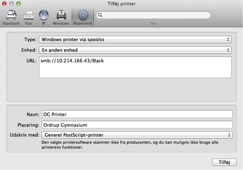

Hi, did you find a solution to your problem? We are using equitrac as well and have no problems to connect to our windows print server from a Mac. But you have to know how to set it up ... : Here is a short description
1) Open Print&Scan in System Preferences
2) Add a new printer by clicking the "+"-symbol
3) Right-click on the grey menubar and choose "Configure taskbar ...". Drag and drop the Advanced-tool to the menubar.
4) Click on the Advanced-icon.
5) Fill out the form:
Type = "Windows printer via spools"
Url = "smb://<windows-server-ip-address>/<shared-name-equitrac-printer>
The rest is simpel. An exampel how it could look is (in danish, sorry):
Now, when you print, you will be prompted for a username and password. Maybe it will only work, if you write <domain>\<username> instead of username.
