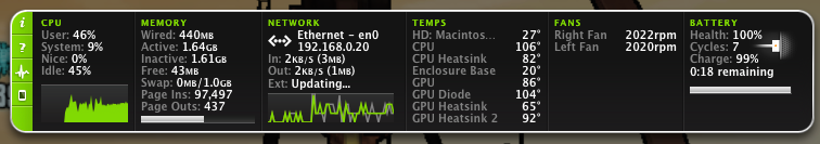

My late 2008 macbook pro is overheating : CPU and GPU diode above 100 and the fans aren't reacting!!
(See picture)
Is this normal?

If you have your original disk you can run the Apple hardware test which will point out any issues. But without it I can tell you that if you can hear the fan then it's failed. You can pick them up on eBay or reputable sellers. It's an easy job.
That said looking at the temp and fan speed I would say your not looking at degrees 'c' but your looking at degrees 'f'

I checked, its degrees celcius, thats the problem!

Then your fan may be failing. You could download a manual control and see if you can crank it up manually. If you can then an smc reset could resolve the issue

Definitely celsius, since some of the other temperature readings would be below freezing if the scale was F!
It does sound to me as if the fan is failing or the sensors are giving incorrect readings.
