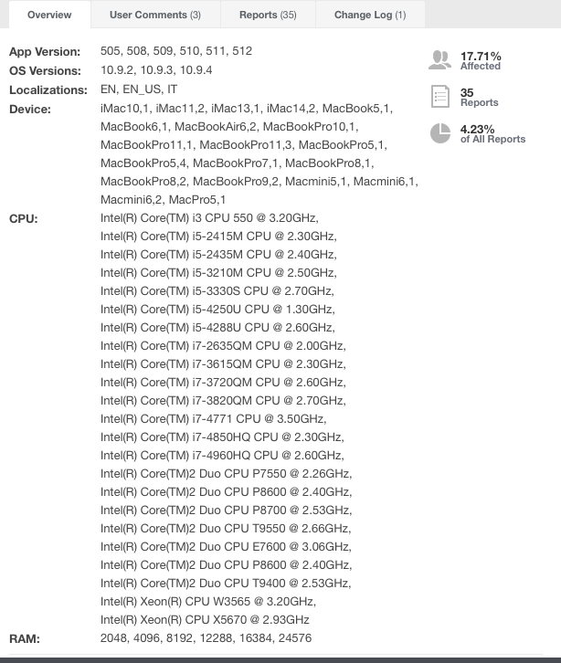

Thanks for the info. Here is the full crash report.

Ruled out the hardware defects (RAM) ? That seems to be the cause of the same crash logs that users posted on apple . com. Whats the percentage of your users that are experiencing this ? If its 10-15% I would go with bad RAM.
Highly unlikely that bad RAM is causing a problem like this. The first rule of programming is it's always your fault.
Thanks for the replies 🙂 I also thought it had to do something with bad ram (I saw a similar crash report with Safari and it was due to "bad" ram.) The crash is affecting roughly about 17 percent of my user install base (55,000+) Also thanks for the article I will recheck my code so make sure that's not the problem. I just wishes I could have replicate the problem on my machines 😕

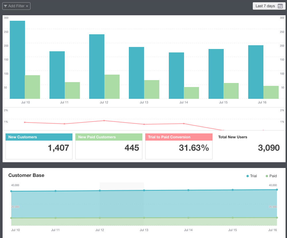

If it is crashing on startup, you have to provide us your startup code. What is you app doing when it starts?
ps: your user base is more like 135~, not 55.000 😛

P.S: My user install base is around 40,000+. I guess there was a miscalculation of the error statistics.

(2) Are you referring to the "Deployment" section of Xcode's Build setting tab?
Are there any other setting I will have to change to achieve this?
Looking forward to your reply 🙂 😀
