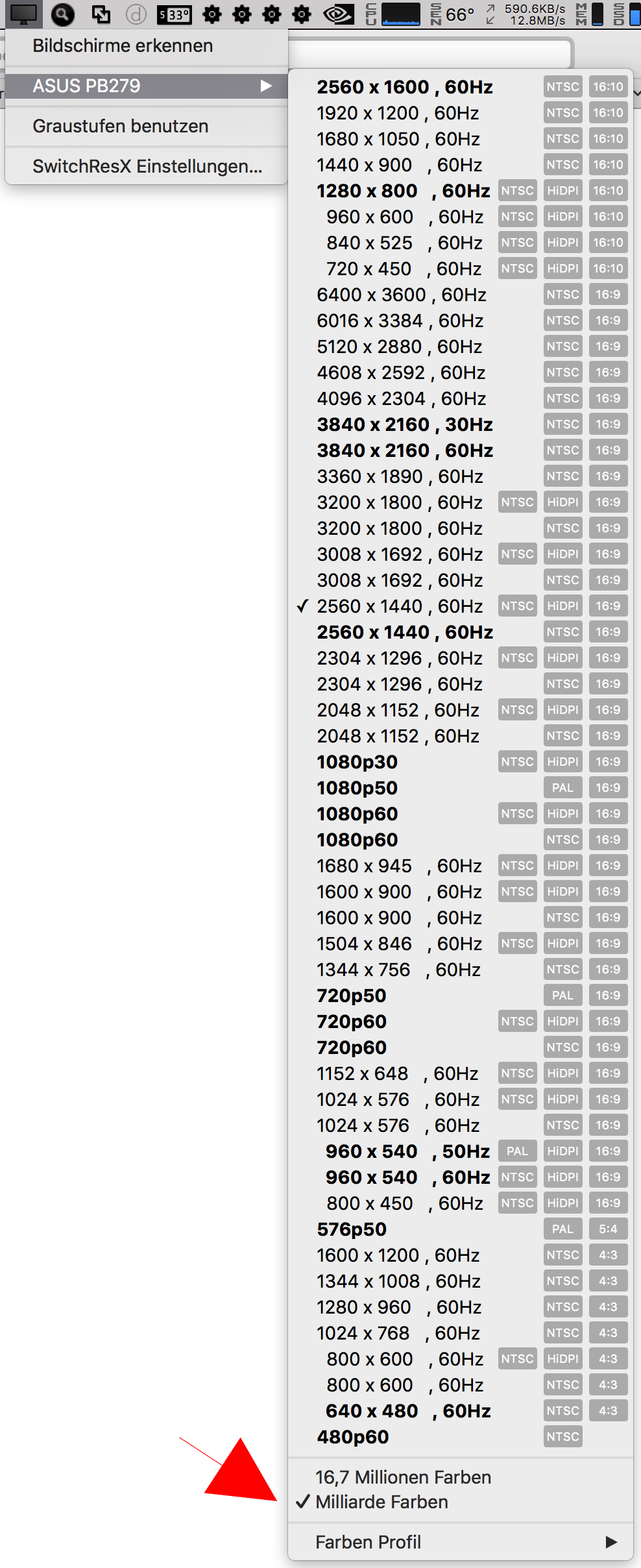

Yes, the Dell U2713h supports 10Bit (using 8-bit + FRC).
When you see this in the system info: ARGB2101010, 10 Bit is enabled.
It's so easy to unlock with SwitchRes X.
So, are there any issues with using Switchres X in Sierra? And, when doing an OS update? Does it break it?
Thanks!
No issues. OS X updates do not break anything. And even if it would break once, it's only a mouse click to reenable it:

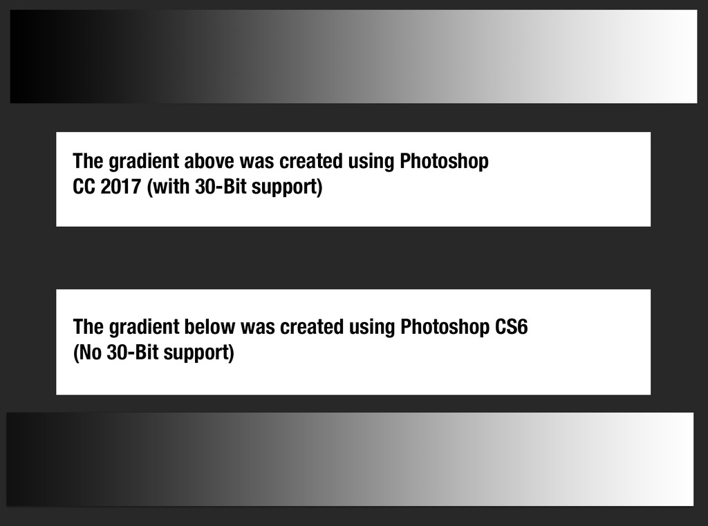

Open Photoshop or whatever you're using, create a gradient from 100% black to 100% white across the width of the screen. If the transition is smooth, you are 30-bit. If you see banding/posterization/dithering, you are not.
The problem is that the entire workflow needs to be 30-bit. So if you see banding it could be the monitor, the OS, the GPU hardware, the GPU driver, the graphics application, or more than one of any of those.

DUH! I didn't know why I didn't think of this before. But, I'm going to download trial PS CC just to test this!
One thing: Afaik only NVIDIA Web drivers support 10 Bit, not the OS X drivers.
Huh. Okay. What about the OS X driver for the AMD Baffin cards, or whatever it is for RX 460?
Anyway, I did a gradient test below.
Obviously, I can't save JPEG files in 10-bits. But, I do see in real life that the gradients are smoother in PS CC 2017 than in PS CS6, which doesn't support 10-bits.
So, I don't know. Maybe, the MacOS Sierra driver for AMD Baffin (Polaris 11) does include 30-bit support?
