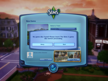

My MacBook Pro never had any problem with my disk drive, to be honest I rarely use it but it never had any problem in inserting any disks or ejecting them, anyway tonight I had some nostalgia and decided to install again The Sims 3, I took the cd and inserted it without any problem, I installed it and once in the game I get a pop up window with two possible choices, to insert the cd and press retry to play or to quit, the thing is that the cd was inside, so when I got this problem I removed the disk to try cleaning it and putting it back in, but now the drive won't work properly, I mean I really need to push the disk almost all the way through before the drive actually takes it and the disk gets read without problems because it appears on desktop, it spins, I can open it's folder etc, I tried even with a dvd from a movie and no problems at all, just that for I don't know what reason, now I need to push the cd all the way through and when I press eject it comes out without problems, just I have no idea why when I'm in The Sims 3 it won't recognise that the disk is there even if to launch the game you need the disk otherwise it won't even start...

[EDIT] I just called an Apple Store support centre and they told me that because it's an older model there si no more support on the disk drives...
