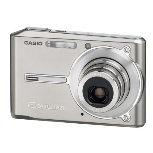

Stupidly, I put my camera, Casio Exilim S600, into a pocket in my board shorts and subsequently got buried in sand and then jumped into the lake to get the sand off. Immediately after, I took the battery out and let both the camera and battery dry off in the sun. You could see condensation under the LCD screen but it's gone now.
About 7 hrs later I got home and took the camera apart, used compressed air and sprayed everything and I think I got most of the sand off. I cleaned some parts with a damp towel and right now I'm going to let it dry for a couple days and then try turning it on.
Am I doing the right thing here? My friend suggested I soak it in 100% isopropyl alcohol to get all the water out or something of that nature. Any advice?

ok it's definitely working. when i turn it on i get a choose date screen which means the whole thing was reset. however, the lens will not open and it tells me to retry power on. im guessing it's a mechanical problem with sand in the lens mechanism.
theres two ways to turn on my camera, power button, or i can press the little square with triangle inside button and it'll take me to the pictures and not open the lens. i pressed the triangle button and everything was working, pictures were still in the sd card, zoom in/out working, menu buttons, etc. so i think everything is fine except for the lens
im trying to do it manually but it's quite difficult. I dont think the sand is necessarily in the lens, it's like stuck in between each 'ring'

I hate to say it, but you predicted this and probably caused *this* issue in your first post.
By using compressed air, chances are you actually forced foreign matter ( sand / dirt ) from the surface farther back into the camera.

Hmmm. I have a very strong shopvac. If it were my camera, I think I'd set the shopvac sucking over the lens opening while trying to open/close the lens. You may get lucky and dislodge some particulate and the vac should catch it so it doesn't fall into camera. Just an idea.
