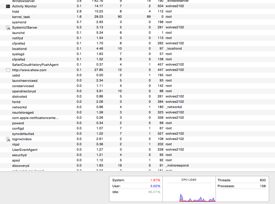

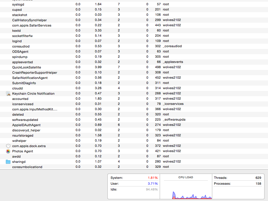

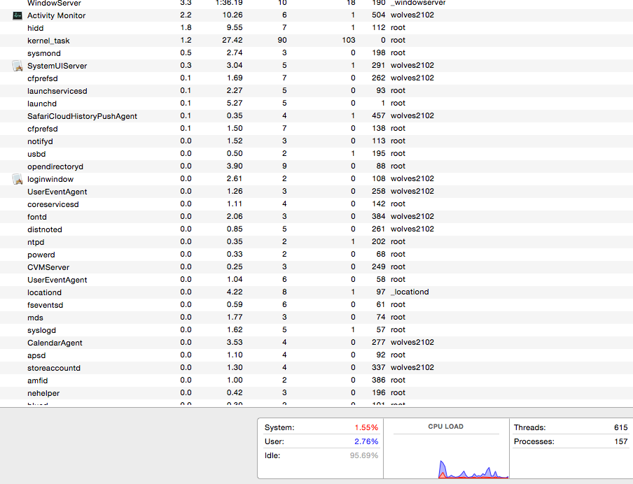

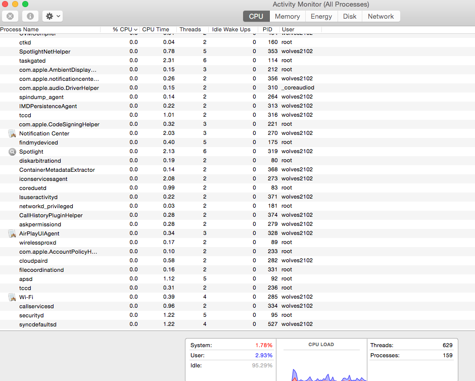

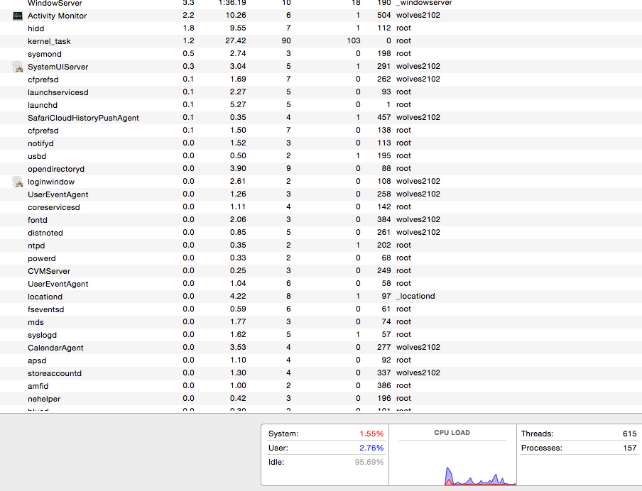

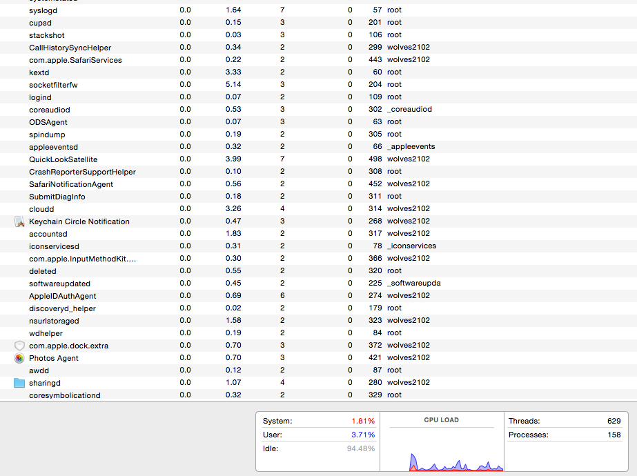

open Activity Monitor, CPU tab, that will show you what is running. Post a screenshot of it...
heres my print screen i don't know where to hit it coz it keeps on changing my activity monitor

Any words for my screen shot? Pls...
Been asleep.
Nothing I can see suspicious there (as I said, if you have reinstalled the OS there shouldn't be). But as you can see there is a LOT of stuff that runs other than your main user apps.
If you hit the issue again, look for items either using more than normal resources or processes you don't recognise, keep a list of what you add into the system, take Time Machine backups and restore to a time earlier than your last addition if you hit problems.
