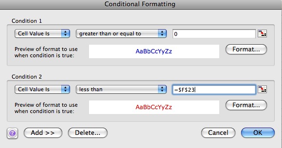

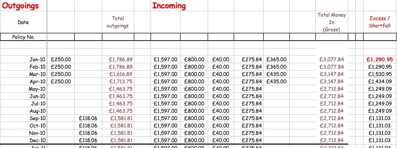

Here:
Nah...thats still not right. I have three columns....
Incoming, outgoing and difference. The difference figure needs to be red if a minus figure and blue if a plus.
This won't do it for me.
You might need to post a screen shot of what you are talking about so we can better understand

What I posted will do exactly that. Just apply that formatting to any cells that you want red/blue, based on negative/positive.
Agreed.
Condition one should be if value of the cell is greater than 0, then use blue.
Condition two should be if value of the cell is less than 0, then use red.
Condition three (if you want) would be black if value is equal to 0.
I'm a meteorologist for an energy company and I use this all the time to show if temperatures are above (red) or below (blue) normal. GGJstudios is exactly right. This is where you need to adjust things to get the results you desire.

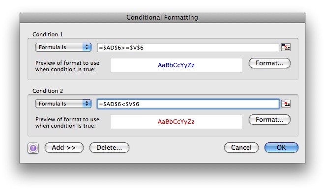

You didn't explain fully what you wanted in your original post. Also, your screen shot doesn't show columns, so I can only guess that "Excess/Shortfall" is column AG, "Total Money In" is column AD and "Total Outgoings" is column V. If you want the condition to be based on other cells, you have to choose "Formula Is", rather than "Cell Value Is":

Ahhhh........THANK YOU very much.

Can you tell me how to copy that format conditioning down the column?

Once you have formatted the first cell, open the conditional formatting again, remove the dollar signs ($) in the cell references and save the conditional format. Then just grab the lower right corner of the cell and drag it down, which will copy the formula, as well as the formatting.
