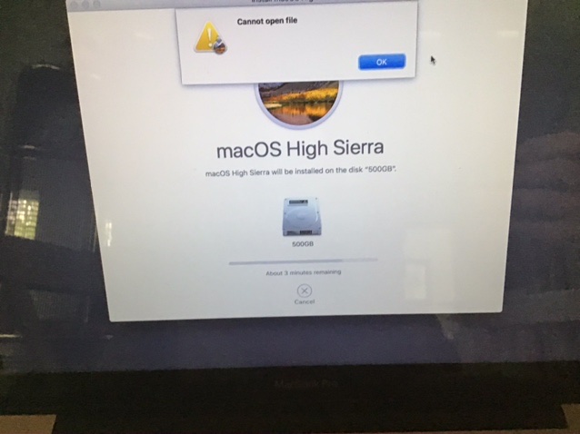

I followed your instructions and this is what I got. Anything else you can think of?
I'm with Audit13, replace the SATA cable. If your MBP boots and runs fine using an external USB drive but doesn't boot up with the same drive installed internally, the first thing I would do is replace the SATA cable. They are known for going bad and are only about $20. I know Other World Computing carries them, probably get them on ebay too. I have replaced the SATA cable on my 2012 MBP 13 twice.
I got my new cable today, and that fixed it. Booted just fine.
Thanks for everyone's comments.
