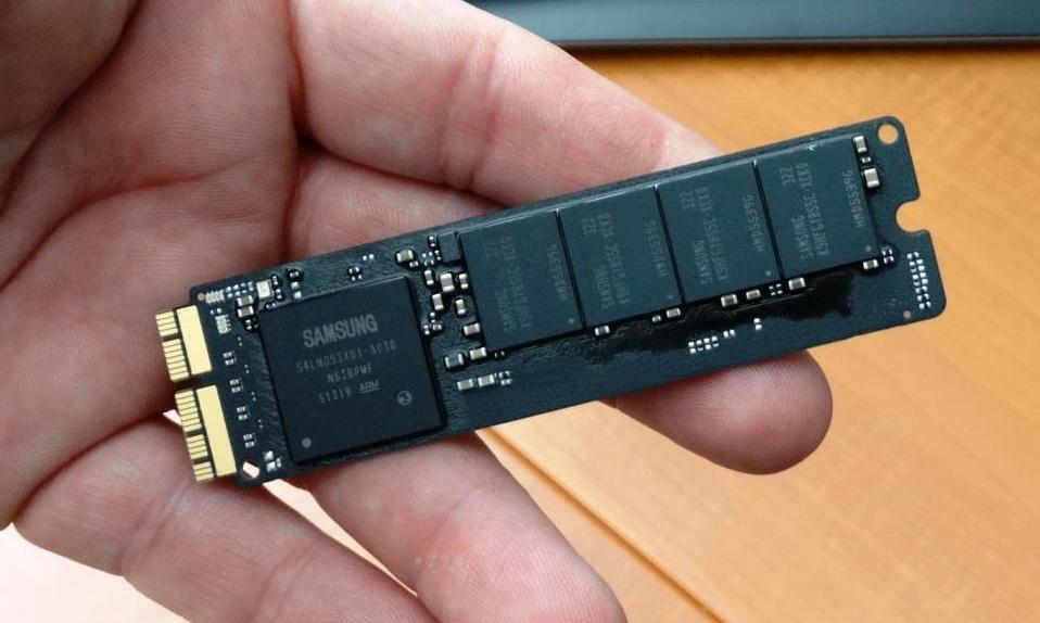

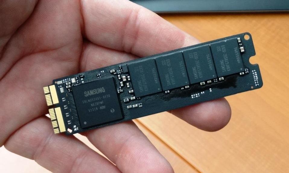

^^^^What I am saying is it appears to have the correct form factor to fit a 2013,. 2014 or a 2015 MBA. Yes, the wording in the listing is scary, and coming from China makes it even more scary. Attached is a photo of an OEM 2013 MBA SSD.
