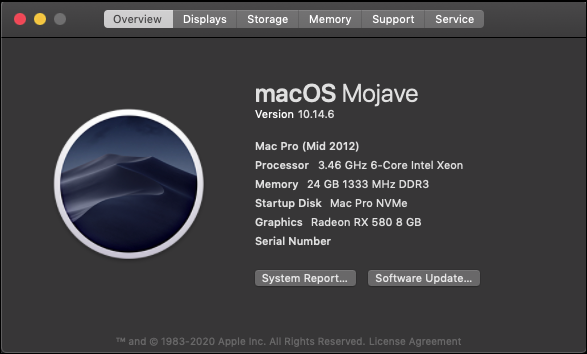

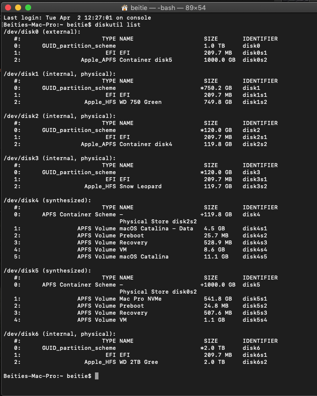

Hello everyone. I'd like to try to update my Mac Pro 5,1 with macOS from my current 10.14.6 Mojave to Monterey 12.7.4 by using Martin Lo's OpenCore package. My current issues are as follows:
1) I'm not able to get into any of the recovery portions of my OS. I currently have three macOS's on different hard drives in this machine. macOS Mojave on my Samsung NVME (main). Snow Leopard on a SATA SSD, and Catalina on a different SATA SSD (Catalina installed by following a thread from a few years ago, don't fully remember it all off hand, and hasn't been booted into in many years.) I'm also using a Logitech Windows keyboard, so I may be pressing the wrong keys?
2) What drive would you all suggest putting the OpenCore onto? I've heard that putting it on the NVME isn't the greatest idea. So the Snow Leopard or Catalina drive could be an option.
Any help would be greatly appreciated.
So today I had time to revisit this. I pulled out the OpenCore SATA SSD, and booted with the NVMe being the only physical hard drive in the machine. So I can confirm that I'm on the proper 144.0.0.0.0 Boot ROM. I'm also sharing the about this Mac screen incase it helps solve any more questions about the system. The GPU is a Sapphire RX 580 that is Mac Flashed (I did this back in 2020), but it does have the dual BIOS so I can switch to an un-flashed version as well.
