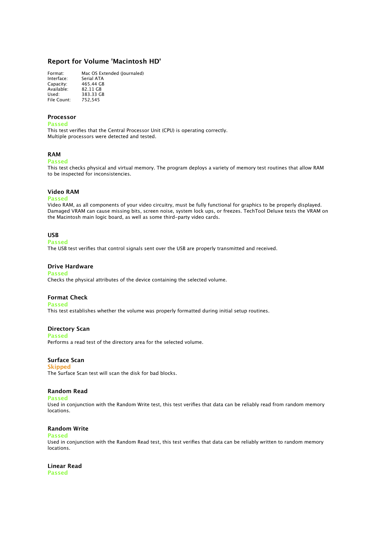

Dear,
I performed the TechTool Deluxe hardware check. (great tip! thanks!)
Unfortunately all hardware pass the test. So I still don't know where to seek for the problem.
I can only assume, but it seems like the Hard Drive get limited in current, and that is when the BUZZZZ sound appear. Each time when I hear that everything stutter and hang.
With kind regards,
Bas

Dear,
With kind regards,
Bas

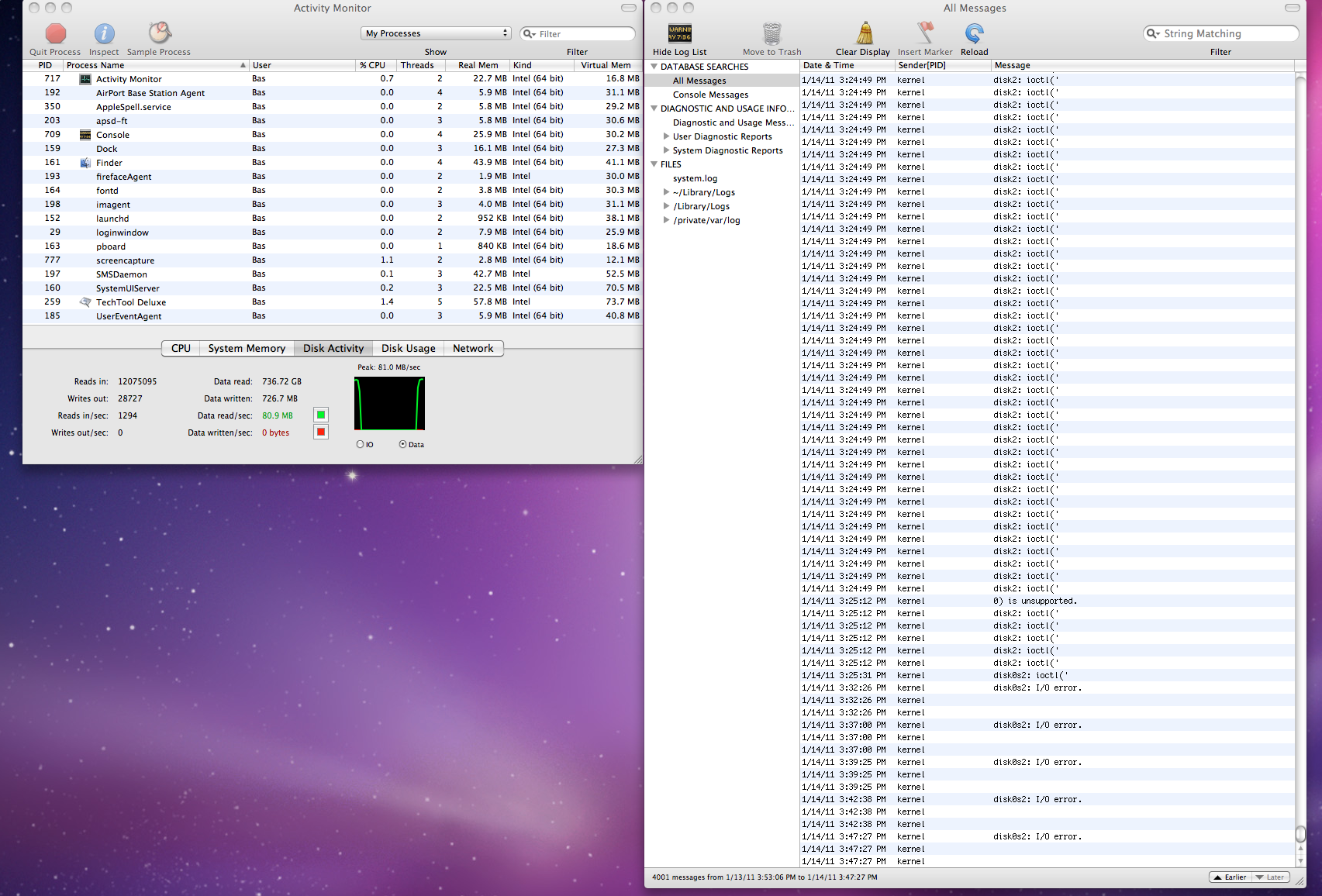

No, not all hardware tests passed. You skipped the most critical one given your question: the surface scan. Run it. It will scan across the surface of the drive, verifying that it can read from every block. Leave the Activity Monitor open and ACTIVELY watch the disk activity. Don't run anything else. If there's nothing else accessing the hard drive, and the drive is in good shape, you should see a constant (gradually decreasing) speed data transfer from the hard drive. If you see long periods where it drops to zero or times that there is much variation in the speed, then your hard drive is in bad shape.
Additionally, open Console.app. If you're running snow leopard, look at the file /var/log/kernel.log. In Leopard and earlier, look at /var/log/system.log. If you see anywhere that it says "disk0s2: I/O error", then you have a bad hard drive. You will most likely see this come up in the log precisely when your system stops responding.
Dear Detrius,
Thank you for your help. I did as you told and Indeed, as soon I hear the "buzzz" sound the line in Activity Monitor drops and the log gives "disk0s2: I/O error"
So we can conclude indeed my hard drive fails.
Lucky I have a full time capsule backup.
You guys helped me great so far. Now I hope you want to guide me to step 2. Which replacement Hard Drive?
My original was a 500GB/7200 RPM.
Any advice for brand/type?
Thanks again.
With kind regards,
Bas
