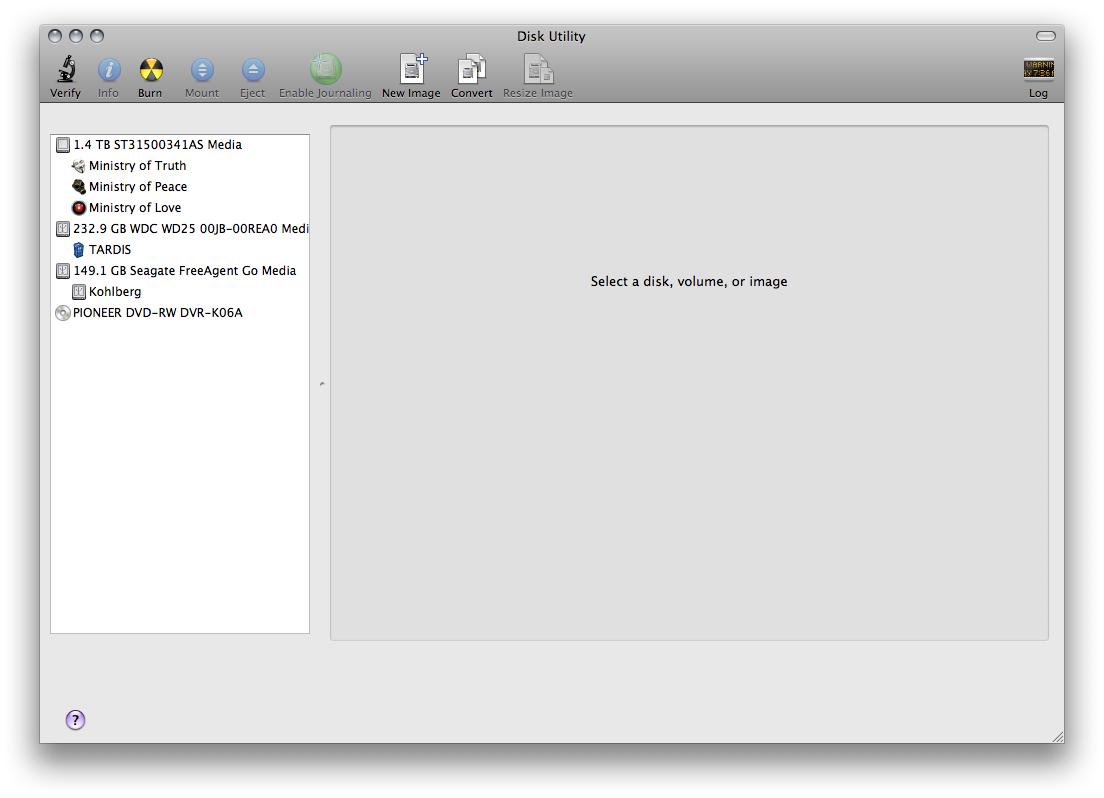

I actually suggest erasing the upper one instead, since it will wipe the entire drive including any unoccupied space.
However, flatfoot is correct about the indenting. This is how it looks with multiple drives and partitions:

When you're looking in DU's window, you may see _two_ icons on the left representing your internal drive. As another poster mentioned, the top one represents the physical drive, and the one(s) below represent the partitions on that drive.
Choose the TOP icon, because you're trying to re-initialize the entire drive.
