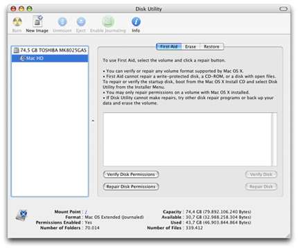

When I boot up my MBP using the Installer Disk, this is pretty much what it looks like (this is not my machine - images taken off the web):
Note there are only two images mounted on the left-hand side: the hard drive and the user drive - the other machine that is connected (G5 iMac) should also appear in this colum, yes?
When I go to "New Image" or "Burn", I get a popup window like the one below which shows the G5 iMac under the "Shared" heading - so I know I have a valid connection.
Remember, the above image is not from my computer - I'm just using these as reference.

If you boot with the install disc, can you still see the drive in Disk Utility? If you can, what is it's S.M.A.R.T. status when selecting the physical drive there?
