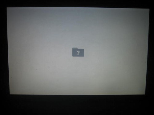

Now it doesn't work. When I turn it on, it makes that sound it usually does when turned on, but there's nothing but a white screen, and a an icon that looks like a gray folder with a question mark on it flashing in the middle of the screen.

And this is the only thing I see when I turn it on. The flashing folder.

That symbol means that it cannot find the startup hard drive.
Press the power button until the computer turns off
Press the power button again to turn it on while holding down the ALT key.
The screen should display a picture of a HARD DRIVE. If it does click on it and the computer should try to start from the hard drive.
If it does not this means that there is probably something wrong with the Hard Drive. Follow the instructions to remove/resinsert it.
Try this first, there are other things you can do like boot from the Restore DVD, but we can cover those later.
OK, so this is what I did so far. I tried to turn it on while holding the alt key, but no picture of a hard drive came up. Still seeing a white blank screen, until eventually the question folder starts flashing again.
Tried inserting the mac os install disc as well.. and after a while it actually went to the installer part, and then I clicked on disk utility and then it froze on me again.. and I had to shut it down. Now it just gets stuck at the white screen again.
I tried the mac os x install disc again, and it goes to the installer part, and then I choose disc utility because I just read that I should do that in the mac user guide troubleshooting.. and the part where I am supposed to use the First Aid pane to see if the utility can repair the disc.. doesn't work. It freezes there.. and now the computer is making a clicking sound.
Sounds like your hard drive could be faulty, take it to an Apple store and let them sort it out, you could say it happened all of the sudden, I'm not saying lie, just don't tell them everything.
